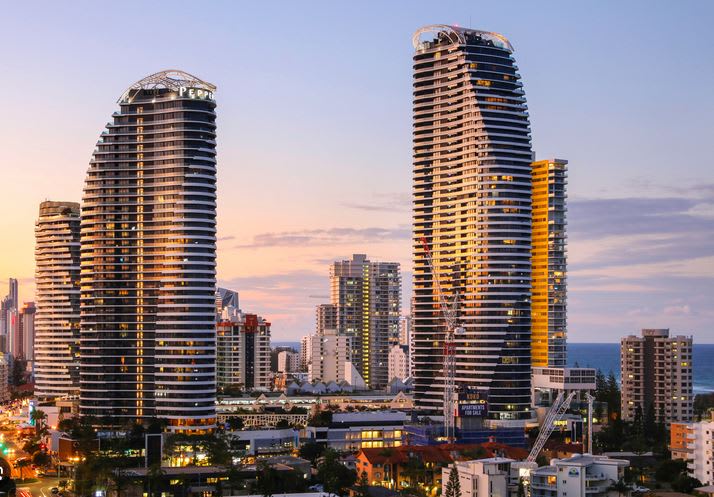

1503-44 said:
If he gives any examples that were actually constructed, it would be interesting to hear the details.
These 40 and 50 storey towers on the Gold Coast (Australia) were constructed with a piled raft. The geotechnical engineers presented at a conference about it.
I understand the savings on piles amounted to millions of dollars.
Millennium towers was also based on geotechnical information... [ponder]
The Gold Coast towers were done by geotechnical engineers who actually knew what they were doing (Golder).
MTN - the talk was good, but I did drift in and out as I was trying to get something out!
But yeah, there was an example of saving of 3.3million dollars for project in Gold Coast so could be the ones mentioned above.
