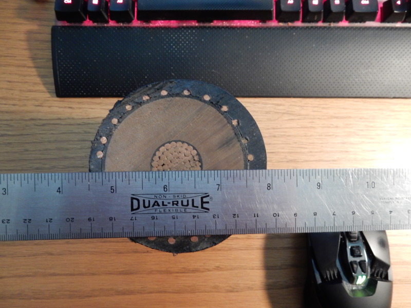

I didn't know that Leyden Jars were used outside of school physics labs... if they are around, they could be historic collectables. I've got an old Roentgen tube from decades back and a couple of chunks of cable samples, the latter from a project. My only electrical part collection.
DIK,
Is that old under sea cable?
B.E.
It's for direct buried; I don't know if it can be submerged other than some groundwater. The project had 4 runs of it (one spare) x 4 kilometers @ $75 per foot going to 6 - 400,000 lb transformers... Oil containment for each was 1-1/2 rail tanker cars. The one electrical engineer brought back a 'sackful' of samples and I managed to scrounge a couple. Prior to that, my largest conductor size was half the diameter and I thought that was huge.
It's new material.. outer poly sheath, spiral wound copper grounding 'cage', a semi-conductor, insulation, a semi-conductor and the copper conductor.
