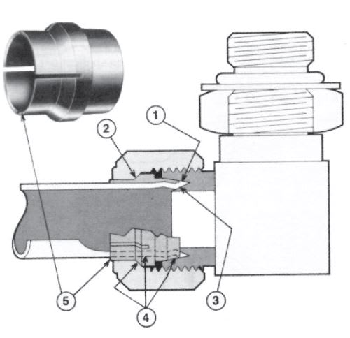

Can anyone identify this type of tube connection? I am looking to find some literature on this. Note the slots cut in the ferrule...
This comes from a 1500 psi HPU - circa 1960.

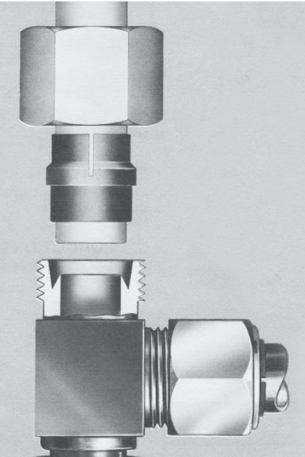

The tube OD is 1". The slotted ferrule is about 3/4" long.
This appears to be a self-flare fitting put out by LDI industries.
Back in the day I believe the company was called Flodar.
See images I pulled from literature here :
I will need to take a closer look at the female side of the connection to see if it has the self-flare interface. The slotted Ferrule seems to match.
