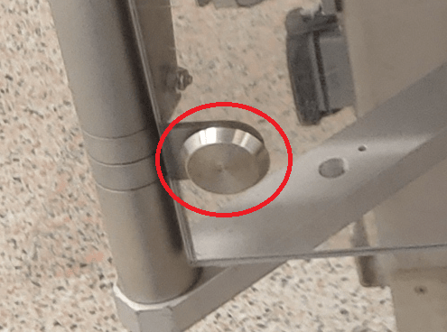

What this shoulder/thumb nut is called?
ESTinker
Aug 24, 2017
40
Anyone know what these are called, they're used for mounting plastic panels so the threads don't make contact with the plastic hole? It's basically shoulder screw with internal threads.
I'm hoping these are off the shelf parts.
The barrel nut is similar but the head diameter is too small, probably specific to spreading the load on the plastic.
Don't suppose anyone know where to get something close to this, threads are M5 the barrel is 8mm OD x 7mm with overall head OD of 38mm?
I expect those are proprietary / custom parts.

Given that these are intended to be decorative vs. purely functional, they would be custom parts.
Considering that many railings with glass panels use something like that, I'd be very surprised if there were no off-the-shelf parts like these. Though they're most likely not standardized.
@ESTinker, do a Google search for something like "glass mounting hardware" or "glass mounting screws".
Even those railing hardware are custom for that particular design. Given the weight of the tempered glass, the bolts will be beefier than what's shown in the OP's photo.
The thread for the end cap is around 1/2"

Thanks for the info, looks like this is custom made out of stainless:
