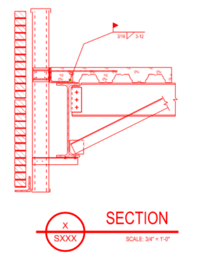

See attached for a few random markups.
I like it. And Microsoft just updated their Whiteboard app, so I use it as my desktop pad of paper now, too. The programmable buttons are great. I have them set up for Bluebeam so I can automatically select the pen, eraser, etc. The pen itself has two buttons on the side. The placement is convenient for clicking - a little too convenient. You have to make sure you have it sitting in your hand correctly or you'll click it while you're writing.
milkshakelake mentioned the holiday pricing in another thread...too bad for me. Though my desk probably isn't big enough for a pen display that big yet. The 12 pro has a writing area slightly smaller than an 8.5x11 sheet of paper. About 10.5"x5.75"
 https://files.engineering.com/getfile.aspx?folder=a5086c54-9b38-4f0c-9cbf-4d575c121d1e&file=Bluebeam_Pen_Test.pdf
Loved your note at the bottom.
I'm extremely happy my college program, even in the mid 2000's, made us do hand drafting and lettering. My writing used to be worse than a doctor's. Now it's at least legible to most.
Thanks. Mine can be pretty rough. The Navy taught me to write in all caps, and I've been doing that for a long time. I'm trying to retrain myself to use lower case because my son's kindergarten teacher wasn't liking his resistance to using them and I thought I should give him a better example. Of course it turns into some strange hybrid between print and cursive that nobody can read. Took me 3 years to teach the draftsmen at my first firm to read my markups...

You need to pump that line weight up, I usually don't go below 5 for the line-weight on the pen in Bluebeam (at a 300 dpi print resolution that gives you nearly a 0.5mm line), they do some really aggressive smoothing after the fact as well so I found more deliberate strokes give better results. If things get too jaggy you can try reducing the "pen commitment interval" to around 200 ms (Preferences --> Window --> Tablet)
