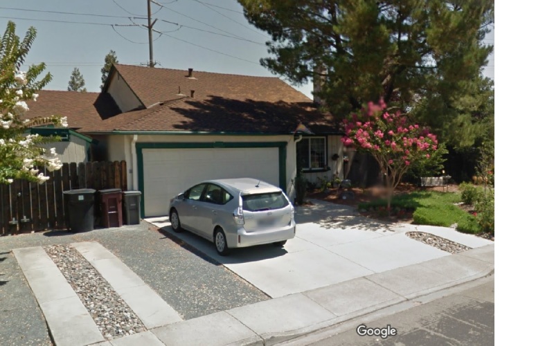

I agree on it being an automated blur. Here's a picture of my house, there is a blur right under the pink flowering tree. Google blurred out a sign my wife puts up that says something about whatever season it is, i.e. "Summer Fun" I think when this shot was taken. No real reason to do that, but the machine doesn't discriminate. I think it helps avoid getting political or offensive signs into the Street View images.

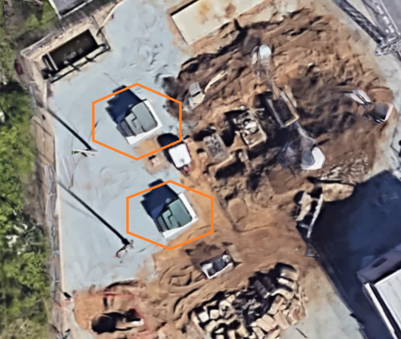

The Santa Cruz location appears to be a messed up image in Google, even if it was being decommissioned or rebuilt. It does show what appears to be 2 newer pad mounts and some kind of digging being done for either new construction or to remove existing undergrounds and/or footings. The Bing birds eye view is definitely an older picture since the adjacent parking lots are not there, and the Bing aerial view is likely older too since those padmounts are not in it. Maybe it's being re-built, re-purposed or upgraded?
