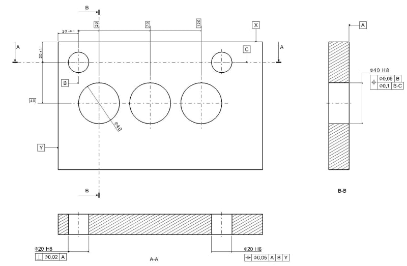

Dear All,
What is this drawing actually mean for an operator. I mean, how will i orientate this part while measuring at CMM.
Also position tolerance of center hole (Ø50) is that right? How can we give a position tolerance information of a hole according to one datum ( Datum B, position tol: Ø0,05 ) ?
I need an urgent help, best regards.!!
What standard are you using/ is shown on the drawing?
If ASME Y14.5 composite callout in the section view is wrong callout.
Might be correct (but not sure if functional) if position shown is changed to multiple single segments (two position callouts).
On CMM I would drive an axis in the middle distance between axes driven from hole B and hole C.
The drawing makes no sense. It looks like an uninformed attempt to use implied datums and suggest that only certain directions are to be used from the related features. Ask the supplier of the drawing to explain what they want and provide instructions.

You show datums[ ]B and[ ]C applied to centre-lines. Datums must be applied to physical features. You can apply them to the holes!

Just throwing my hat in the ring here too. This drawing is toast. The responses here totally reflect the responses in the CMMguys forum where you posted this first.
If you attempt to check this part to this print just like it is, you are just generating numbers that don't mean anything.

Here are some observations:
1. Like pointed out by drawoh, B and C datum feature symbols should be connected by leaders to the circular outlines of the holes. Not to any centerlines.
2. Question about the composite control on dia. 40: is the first segment referncing only B meant as an orientation refinement of locational position with reference to B-C? If so, switch places between segments. Also, it's a bit unusual to see position refinement referencing a nominally parallel datum. Usually it is meant as a perpendicularity refinement. I wonder what the others will have to say about that.
Another thing - you need a basic dimension from that hole to the plane through B and C. (My bad, you already have the 40 basic dimension).
3. You need to loacte the upper right small hole to datum feature hole B, with basic dimension.
4. The directly toleranced location coordinates of datum feature hole B should be basic and it should have a position call out to A, X and Y datums. Locating a feature of size by +- tolerance is not considered a recommended practice.
