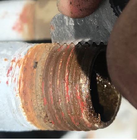

Hello all,

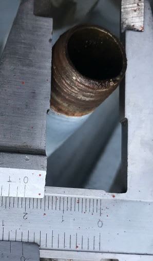

Could some one please help me in determining what is this thread type from the image? I have atatched 2 images showing thread gauge used by end customer, & rough measurement of major diamater.
it says 14G 7/16 on the thread gauage from what i have been told.
I am really unsure whether its BSW/BSPP or some other thread.
From this
It looks like a 1/2" BSPT to me. 21mm / 0.8" diam
Looks like a taper thread, but might need a check on a straight edge along the fitting to make sure.
This also has same dimensions
