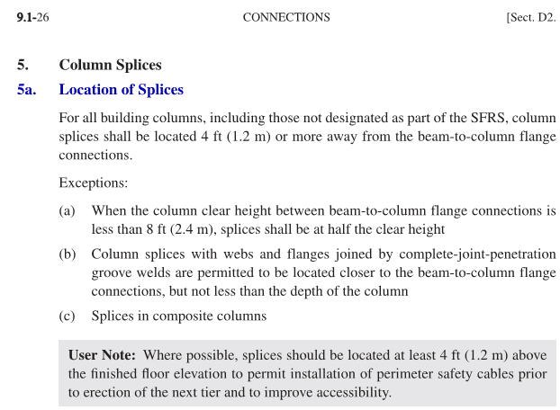

What is the minimum distance between the splice and column base?Are there any American codes containing some requirement?

phamENG said:Indeed there is. It gives requirement of distance between column splice and beam-to-column flange connection. Thank you very much.
