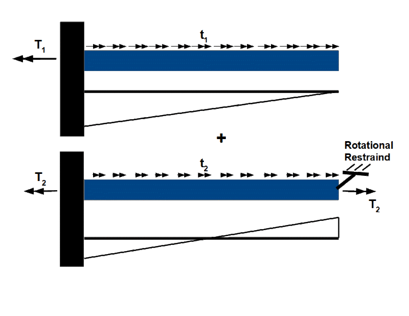

The total torque at each end is the sum of the cases below.
Correction: Both T2 shall pointing left side (the right side reaction was drawn in the wrong direction)
The system sees torsion only. And the reason for even asking this is designing the hard stop. I want to know if the hard stop sees full torque OR half torque OR 25%.

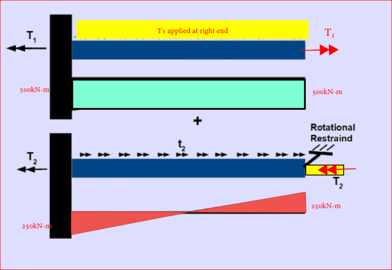

My bad. I goofed. I agree with 75-25 now. But it's late and I will think about it overnight.
Okay, thought about it!
T1 is applied at the right end, not uniformly over the span. T1 at the fixed end is in the opposite direction. When the end stop is fixed, T1 does not change and the beam remains rotated at 15 degrees.
T2 = t2*L/2 where L is length of beam. T2 is the reaction to a uniform torsion and is in the same direction at each end.
Maximum torque reaction at fixed end is 750kN-m after uniformly distributed torque is added.
Maximum torque reaction at end stop is 500kN-m before uniformly distributed torque is added.
Torque reaction at end stop after uniformly distributed torque is added is 250kN-m.
