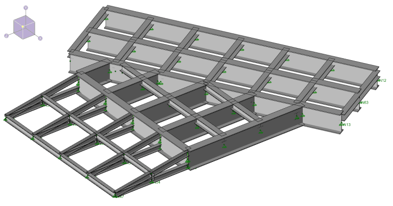

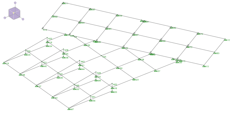

I have attached some screenshots of a rendering and then a wireframe of my structure. It is a really low structure. It is meant more for a pipe crossing and vehicles are able to drive over it, too. I have a 1" steel plate at the top of the structure, and a 1/2" steel plate at the bottom of the structure. I just want to be sure that I get the boundary conditions correct. Thanks to all that have responded so far. More specifically, what are the boundary conditions between the bottom flange of the beams and the bottom steel plate. I am thinking more along something between a pinned and a fixed condition, but like to hear from you all out there, please. The bottom of the beam flanges will most likely be welded continuously or be stitched welded every so often to the bottom steel plate. Bottom steel plate not shown in the attachments, but it is there.
I would model compression only spring supports every 12" below all of the beams that are bearing directly on the bottom plate which is bearing directly on the ground. You'll have to make some assumption for what width of the bottom plate is effective at transferring the load to the ground, so using the beam flange width may be reasonable.

Ndrds20 said:
The purpose of this frame is to allow pipes to cross the roadway. The roadway cannot be disturbed in any way because of a specific reason. Now, what is the boundary conditions between the beams and the steel plate. Now, the beams are welded, or even bolted, to the steel plate. Would it just be a pinned or fixed condition, depending on how the beam is attached to the steel? Initially, I was thinking about spring constants, too, but after further thinking, I believe that spring constants has nothing to do with the beam. The spring constants will be the supports for the steel plate underneath the whole structure, but that’s for another day.
I will ignore the statement in red for now, although I suspect it is a pretty tall order to expect the roadway to be undisturbed during and, for a while, after construction.
If the beams are welded to a continuous 1/2" thick plate, either continuously or stitch welded, they would act together. The terms 'pinned' or 'fixed' are inappropriate. The properties of the beam will be modified by having an additional bottom flange attached to it. The centroid of the composite beam would move down. The area, moment of inertia and section modulus would all change according to normal structural theory. The heat of welding will change the initial curvature of the beams and plate.
I'm happy to let the spring constant go for another day, but I cannot understand how it is possible to arrange for the underside of plate and top of grade to align accurately, so I suspect that some of your springs will be engaged early and others, not for a while.
BA
ProgrammingPE,
I was going to state that the beams are attached to the steel plate and not to the ground, and so the boundary condition between the bottom of the beam and the steel plate should be a pinned, fixed or something between pinned and fixed condition. However, BAretired did put forth a convincing argument against that. More on this later. What if after the beams have been welded to the steel plate, then the steel plate is placed on a solid concrete foundation? Or, if the steel plate is place on top on a pipe rack? The steel plate does not see any ground. Would it not be clear then that the soil springs have no role in the beam's boundary condition? I am not saying that I do not like the idea of the compression only soil springs at the bottom of the beam. In fact, I like the idea very much and the steel plate is going to be placed on the ground, but just being a devil's advocate here.
Now, back to BAretired's response. I must say that this seems like a convincing argument. The beam being welded, or even stitch welded, to the steel plate, makes the steel plate part of the beam now. Part of the beam, the newly enjoined steel plate, is sitting directly on the ground now, and that may be why the compression only soil springs will work. I must say I did not think too deeply about this initially, but now that BAretired has mentioned it, it does seem to make sense. The plate has become part of the beam.
