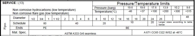

Any reference for Max size according to A333 pipe available?

But Most of the Engineer companies proposed A671(EFW) material For the above 16"(Without consideration of Thickness) .
Note: The main different is Manufacturing Process(Welding)===>With & Without filler metal.
Seamless pipe up to 24" has been readily available in the past. I only new of one mill hat could produce seamless up to 36" but that was some time ago.
As you see Practically,companies proposed A333 ,up to 16" as SMLS, and A671 for above 16" as welded.
However, There is no limitation in A333 STD up to 16" .
You seem to be interested in the economic choice between seamless lower strength pipe and welded slightly higher strength pipe and not how large a diameter that A-333 6 pipe can be obtained. And you don't state the source of the Table shown. Per Owner's request, I can assure you that larger diameters of seamless A-333 6 has been specified, purchased and installed in low temp petrochemical facilities.

SMYS of the two pipes appears to be the same (240 MPa)

Normally ,According to Companies Experience for the Above 16" ,They propose Welded type with SAW Welding method

This is why that the Engineering Companies will not propose A333 for bigger sized.
Any Technical Idea will highly appreciated
Which "Engineering Companies"?
Now it is true that up to certain sizes, seamless is easier to find, but I don't understand why the piping index you list doesn't simply use A333 welded pipe above whatever arbitrary size the company wants to choose below the generally recognised limit for seamless of 24"
The other pipe material might just be more commonly available in your part of the world. I don't know. Have you asked the "Engineering Company"?
