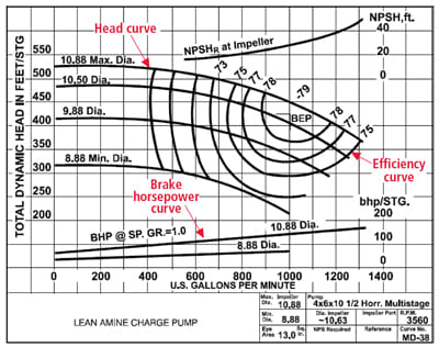

Where you are going wrong is this.
When you run the two pumps in paralell you do not get double the flow but somewhat less. It does depend on the system but two pumps may only give a few percent more but 10-25% more would be typical.
I will use some made up numbers to demonstrate the point.
You have two identical pumps and they each pump when operating alone 100m3/hr at a head of 100metres. In my made up system at 100m3/hr the total head in the system is 100metres. At 110m3/hr the system head increases to 120m, at 130m3/hr the head increase to 150 m and at 200m3/hr the head is 400m.
We know that these standard pumps decrease in output as the head increases.
One pump is pumping 100m3/hr at 100m head when we start the second pump. The second pump at start up because it is in paralell immediately is working against 100m head but as it starts to pump the flow increase somewhat. Lets say the total flow is now 130m3hr in the system so the head is 150m. The flow has increased by 30% but the head has increased by 50%.
In this case if we looked at the pump curve we would find that at 100m head the pump will produce 100m3/hr but at 150 m head(which is what it sees at the discharge because the pumps are paralell connectted) it will only produce 65m3/hr which is half of the total flow of 130m3/hr. So whilst bringing the the second pump online increases the total flow the increase in flow also increases the total head which reduces the flow per pump.

You need to look at and understand pump curves like the one below.
The pump speed is constant.
The pump flow will vary depending on the back pressure of the downstream system (pipe, chiller pressure drop etc). This will impact on the pump flow which tracks the particular line.
So in this example, if the impellor is 10.5 diam, the required head from the pump is say 400 ft, then the flow will be 1000 gpm and the power approx. 145bhp
If on the other hand the required head from the pump needs to be 450 ft to overcome the friction losses, then the flow reduces to 750 gpm and the power also reduces to approx. 120 bhp.
This is the same pump running at the same speed. This is how centrifugal pumps work.
Understand that issue before you move on.
