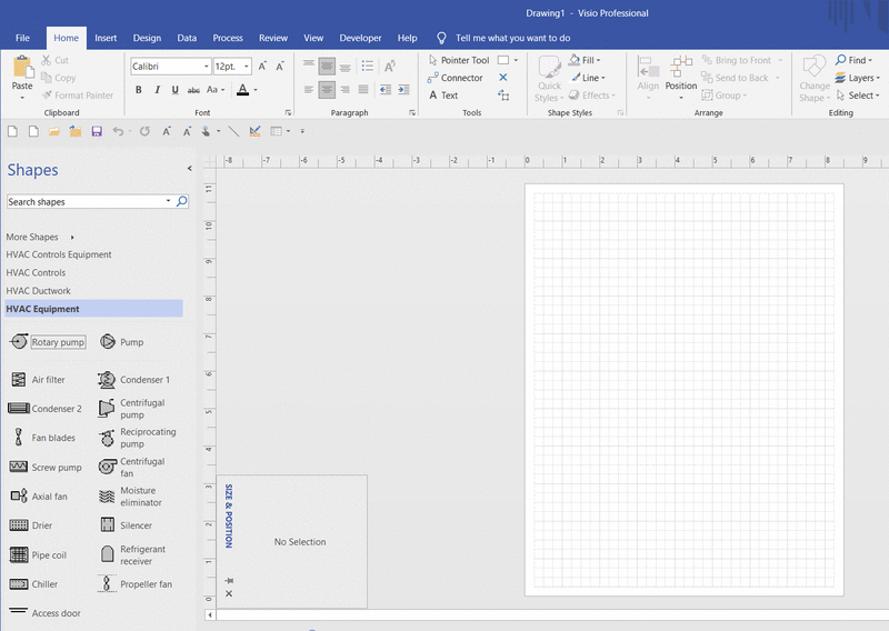

Until now I've just been doing all of my diagrams in autocad with lines but I'm looking to get a more robust program that's easier and faster to use. I've used HVAC Solutions but I have to say that I didn't like it that much, it was too restrictive. I'm thinking about using Visio; has anyone tried that? Thanks!
Visio is kind of an in-between application, less capable than Autocad in many respects, but able to higher level things
TTFN (ta ta for now)
Thanks for that. That's interesting that they're showing how to use it for floor plans, I wonder if anyone actually uses it for that.
