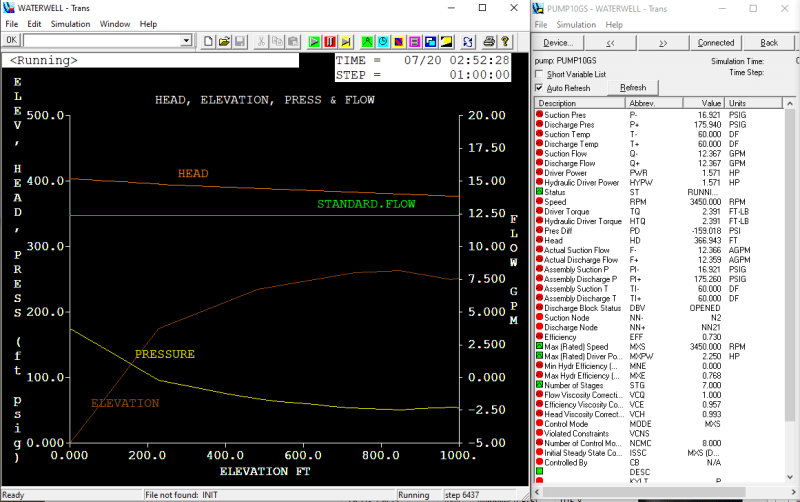

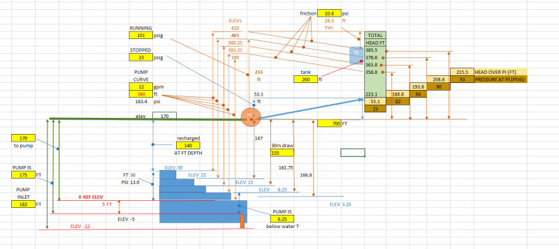

I've been doodling around with your system there.
Here's a nice picture of the system, as much as I can imagine.
Mostly according to what you said, which I have distilled down to the following in the quote box. It would be great if you'd have a second look. There were a lot of water table depths mentioned as well as pump depths.
I'm not totally sure about some, as pump is 8.25ft below water, but which water table level was that. Water table depths are actually more important than pump depths. Head delivered by pump is measured from the water table, so there are a bunch of total head elevations when the pump is running and pumping from different water table depths.
The 23 psig valve reading is interesting, because that would indicate that the tank is only 53 feet higher than the gage, yet you have said it is appx. 200 ft up and 700 feet away (but terrain was difficult to gage). Was that happening when the broken check was there? If so. what does it read now when the pump is off? If the line is full from well head to the tank, the PI should read Height_above_PI_feet x 0.4333 , maybe now around 90psig??? If it is not reading 0.43 * height_ft, there could be a pipe leak.
Keith said:
"1.5 hp pump 170 ft down"
"Sch 80 riser"
"Berkeley pump"
"Pumps same 15gpm into 230ft dynamic head"
"Flowrate is 12gpm"
"There is a gate valve at the tank sump"

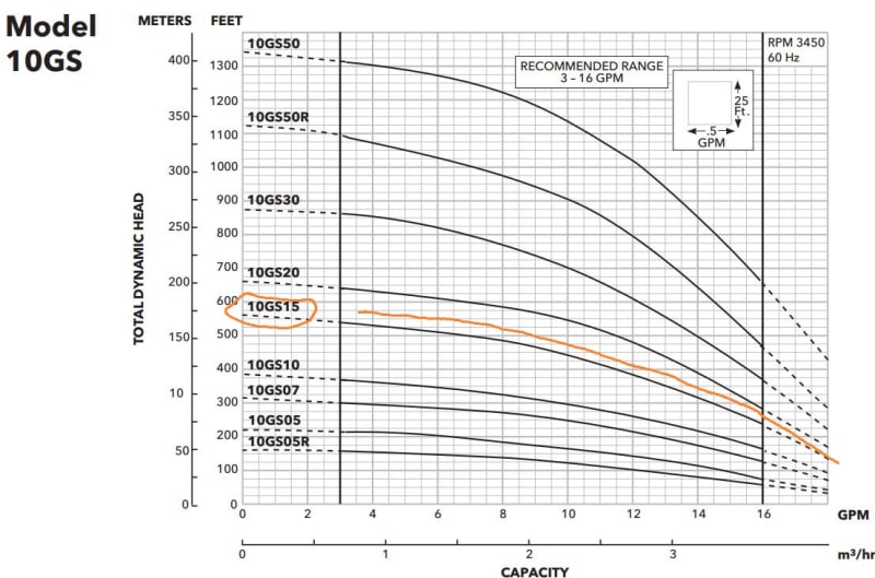

Pump curve
D MODEL10GS15 HEAD 7 /* 4 IN 1.5 HP 15GPM
560 550 440 380 350 310 240 /* FT
0 5 10 12 13 15 16 /* GPM
"Water Table is 140 ft below wellhead" <<<<<<<<<<<<<
"8000 gal tank"
"Pressure gage reads 101psig when flowing"
"Pressure gage reads 23psig when not flowing"
"17 stage centrifugal"
"Draws 10.8A FLA is 11A"
START UP: "Pressure runs up to 130, falls to 85 then steady at 101. All in 2 seconds."
SHUT OFF: "Pressure falls to 25 psig instantly".
"A built-in check valve at top of pump at the bottom of well exactly 180 ft down."
CONTROL RESPONSE
"Choked the flow down until (well)head pressure went from 99 to 102.
Turned the valve wrong way (closing it) and pressure spiked at 150."
1-1/4 pipe sch40 horizontal 700ft and 200ft high
Pump inlet is 182 ft from casing top.
Recharged well is 140 ft below casing top.
30min draw drops to about 155ft.
4.5 min to fill the pipeline to the tank

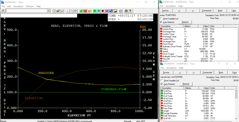

WATER HAMMER
OFF 26 psig
START
0.75s = 145 psig
0.76s = 75 psig
1.20s = 100 psig
STOP
0.5s 26 psig
6" well casing
THANKS KEITH

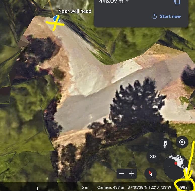

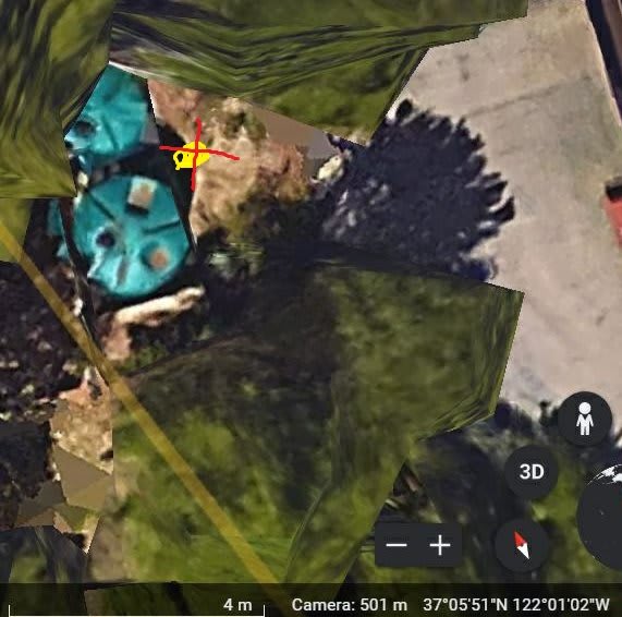

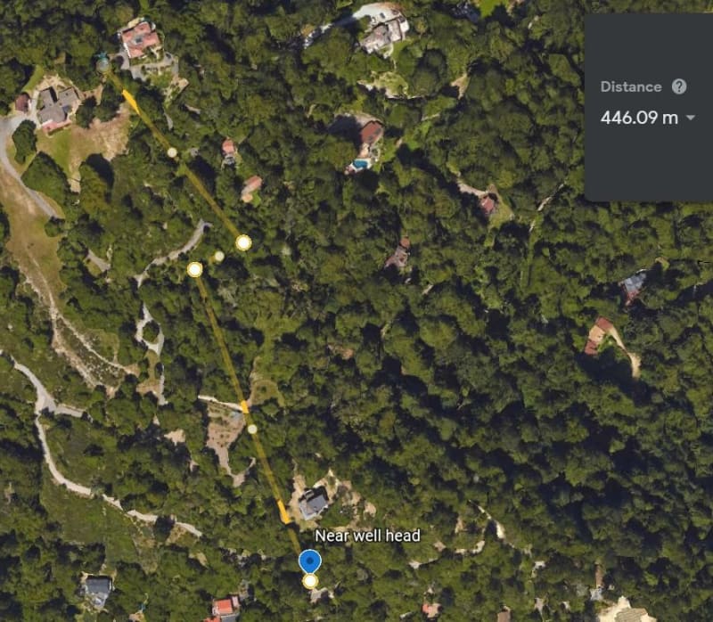

This got me looking at things and talking to a utility engineer who specializes in well systems. He told me he uses Google Earth all the time to do work-ups. He's stopped bothering to tape-measure things because of GE'th great accuracy. He's especially impressed by the vertical accuracy. He explained that he can put the cursor on the ground tanks are on and then move to the top of the tank with the cursor and it's always within a foot of the tank's actual height.
The lateral distances seem to be spot-on.
So going with that lets see how reality stacks up to my feeble estimates.
So distance is: 446m x 3.28084ft/m = 1,463ft
Only off by 2x!!

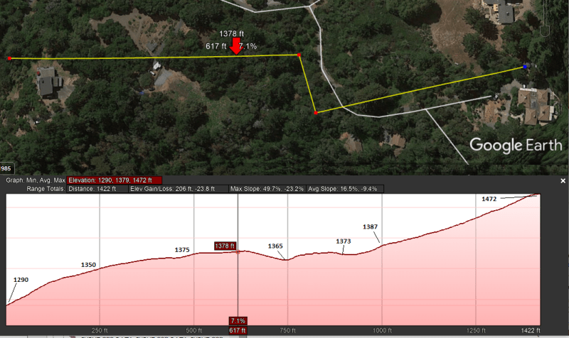

Height is:
So that's 389m except the well head is under trees and up 4 meters from that spot in the road. So the well head is
389m + 4m = 393m (Note: the value on the screen is wrong by the time I've captured the screen shot! It reads 389 NOT 398.)
393m x 3.28084ft/m = 1,289ft
450.0m x 3.28084ft/m = 1,476ft
So the elevation difference is:
1,476ft - 1,289ft = 187ft
Summing it up:
Lateral distance: 1,463ft
Elevation difference: 187ft
Tank inlet is 10ft above tank base.
I deleted the gauge with all the plumbing hassles noted above so I don't know the off pressure now. :/

Super. That's what I needed. I was going to suggest GE elevations. They are pretty accurate in general. They are taken on a 100m grid, so unless you have a vertical cliff, they work well. In fact sometimes the elevations can be more accurate than the photo placements. I've done preliminary hydraulics for a bunch of pipelines 100 to 2000km long with GE. I wish I had that back in the 80's.
I've got the tank at 205ft elevation now, so 20 ft lower is a smack on at double the length.
Yeah, its certainly possible the check wasn't sealing quickly and allowed some spillback.
Thanks.
You can pick off elevation profiles and set masurements for feet and miles if you want.
Statements above are the result of works performed solely by my AI providers.
I take no responsibility for any damages or injuries of any kind that may result.
With a long, long profile, you have to zoom in at various points alone it to tell GE that you want to have detailed elevations in that area. It can take a few minutes to gather all the elev data. It collects more detailed elev data based on the zoom view scale, just like the detail it shows in the picture tiles. But then don't zoom out too far or you can lose it.

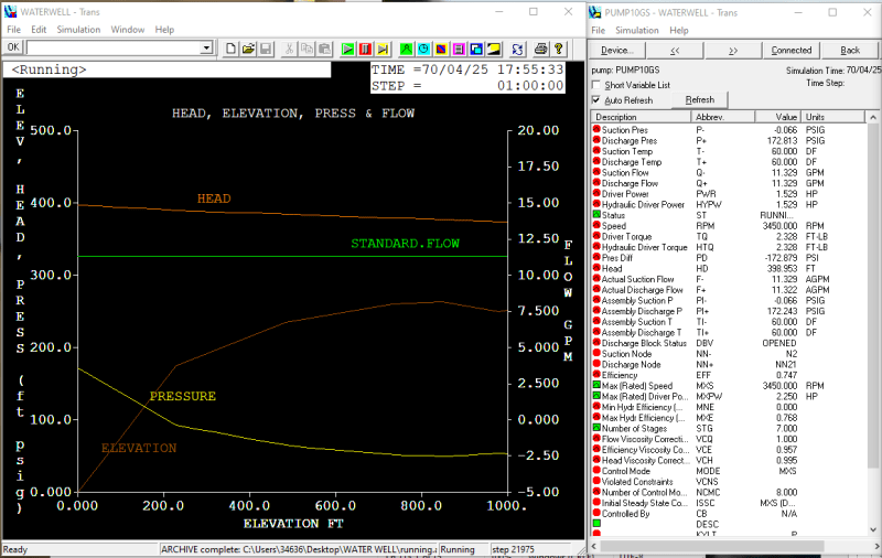

Water table at 140ft depth...
Water table at pump inlet ...

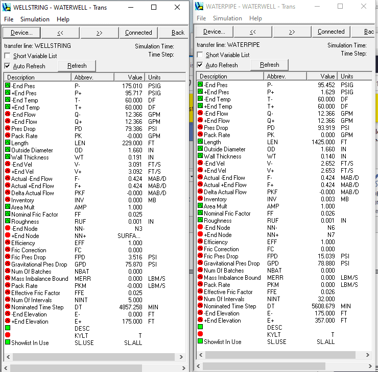

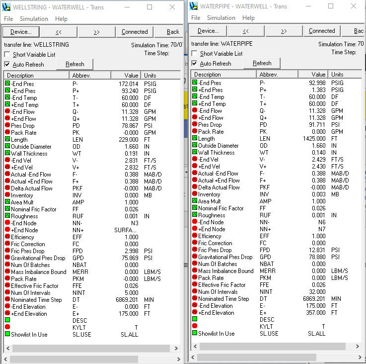

Max pressure.
I can't bust this pipeline, even when closing an imaginary snap action valve in 1/16 of a second. Velocities are slow.
Worst max pressure case is a closed valve at the tank with the pump still running.
Best WAG is that the riser broke due to overloading for 5yrs and aging of the sch40 PCV. What is its max pressure rating? I did not look at that. 260 psig at bottom of riser here.
Check valve, don't know. Sand erosion? Corrosion. Fatigue?
