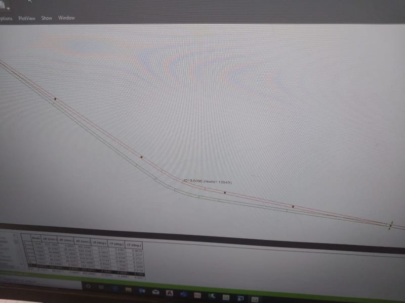

greetings all,
i have a pipeline 1700m size 10in and wall thickness 12.7mm its condition is laid aboveground on concrete sleepers with intervals every 15m the pressure is 82bar and temp 85c the main issue here is due to the client requirement and site issues using any loops with hot bends or even zigzag configuration with cold bend are not permitted after analyzing the pipeline it gives at the change directions bends (2 bends 21deg and 32deg) which are of cold bend type with radius 40D because also the hot bend for changing direction is not allowed, the deflection (displacement) at the bends body reached 1m laterally we tried to put anchor blocks to reduce it but it had load 150ton which is a huge load to design anchor block (4m*4m*4m) so even the anchor blocks is not a solution the question here is 1m deflection at bend body is acceptable noting that:
1- the supports are not an issue we will make it wide enough to let the pipe move freely on it
2- the max stress ratio from CAESAR analysis is safe 82% for all cases even the expansion case
3- my main fear and concern here is the strain as far as i know CAESAR is single beam theory software and doesn't commodate any effect of strain and the 1m deflection in the bend body could cause work hardening making the material to behave more brittle and fail due to crack which caeser is limited software to check such effect and need to be studied using Abaqus FEA ,is my concern valid or not and based on experience what is the value of maximum deflection allowed for the pipeline as there is no standard or company spec state such value for pipeline all have only for piping which ranges maximum from 120 to 150mm

1m in 1700 = strain of 0.0006 m/m. This is not excessive in a straight run of 1700m. However a 1m movement at a bend may induce considerable bending in the connecting pipe. It is important to understand the possible effects there. What does the connection to the rest of the piping look like where this 1m movement of pipeline is being observed?
no the 1m not for 1700m pipeline it is in a short span again because I use guide to restrict the lateral movement see the attached photo this is from the analysis and the amplification factor for displacement is 1 so as shown the 1m deflection in the bend body itself and at the two rest supports that adjacent to the bend then it decrease to .5m for the second support then eliminate at the guide support so basically the 1m deflection is in the bend body itself 12m at maximum

The strain does not happen in the bend alone. The strain is still small m/m. You simply see the total at the bends, but it happens m/m. At the bend, the displacement induces different bending strains and stresses, but you say it passes allowable stresses. If strain is high there, check cyclic strain hardening there at the bend only. If it passes stress, you likely have low strain. If strain is very low, work strain hardening = force x strain/ time, accumulating enough work to do damage will take a very long time to develop, even with lots of cycles.

its axial limit stops have detail configurations as two supports with concrete in the middle with a gap 50mm also it is supported with v shape structure with the ground and this is my least concern as the civil team will confirm design of such support that will not fail under the supported load, secondly how I can even determine that I am in the elastic zone without performing FEA that what I am asking that caeser will not be adding value in my case, who is approving is me as I am the consultant in the project and I am searching with the engineering contractor the most applicable solution, lastly the client so anti expansion loops as I answered previously (the project is critical in time and the site doesn't want to wait the lead time of hot bends as for the zig-zag it refuse it as the first initial trial resulted in 10 zig-zag configuration (every 150m) to result in only 15cm deflection but the site refused such configuration for lack of construction experience,)

The stress report shows you if any part of the pipe is above the maximum allowable stress / SMYS. If not then you're in the elastic zone no?
Then bury it if you don't want a 1m expansion, but you might find the bends are overstressed when you do that. Try it and see what happens.
Above ground line stops can only handle a relatively small force - say 5kN or less - before they turn into massive anchors.
