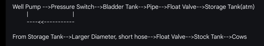

I have some design queries here.
You want to use the well pump to supply water to your home and the feedstock.
The pump should supply water to a bladder tank for the home and an atmospheric tank (storage tank) for the feedstock.
The control of the pump is set by the bladder tank pressure - cuts in at 40 psi and cuts out at 60 psi.
Query 1: How to fill both tanks by the same pump? Options are:
Option1:
Storage tank fills first because there is no back pressure (atm tank).
Install a float in the storage tank, so that supply gets cut off once tank level is achieved.
Pump fills the bladder tank.
ideal time for this operation is at night when there is no user.
Option 2:
Use option recommended by Peirreick.
Query 2:
Storage tank location (at highest elevation) shown on the topography map tells that the @1750' away tank will be pressure fed by the well pump. So, it's not a gravity flow.
Query 3: How far will be the stock tank from the storage tank? This leg will be gravity-flow. Is this what you want to design for gravity flow?
If you want gravity-flow right from the source (well pump), you may think about the scheme recommended by peirreick for what he has done for his home and orchard.

Q1: Planning on option 1, however a concern is that pipe friction generates enough resistance that the bladder tank fill to cut-out pressure before the storage tank is full causing extra stops/starts of the pump.
Q2/Q3: Correct. Storage tank is to be fed by well pump. Not shown on the drawing is the stock tank, which is to be gravity fed within 150' of the storage tank in various locations. The cattle are restricted to small areas and rotated to allow the pasture to rest and recover so the stock tank gets moved around also.

Littleinch,
I think this problem can be solved by sizing the tank adequately with enough volume so that the feedstocks are not left thirsty. The level float simply works to close the water supply from overflow but don't have the functionality to start the pump when the level falls.
The storage tank volume should be enough to supply all feedstock for one day (assume the tank gets filled at night). Peak consumption demand is required.
This is where things might go expensive. Friction loss can be reduced with larger dia pipes. Do you want to do a cost-benefit analysis between installing the storage tank at your yard running smaller pipes vs locating at 1750' away with larger pipes?
