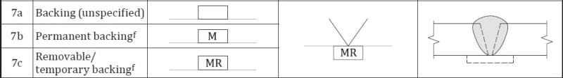

welding symbol 6
It's a butt weld ground smooth...I don't know what the 'M' stands for.
Dik thank you for the reply, could be NDT requirement
Square groove butt weld welded all around with a flush/flat finish.
The M may stand for Mechanical as in grinding to achieve the flush / flat finish.
A bit strange as it shows a single sided joint with no backing ?
thank you for taking the time to reply, stars for both of you
Under EN/ISO, the M means material backing (could be metal, flux or ceramic backing but not gas backing). But it should be on the other side of the reference line...
Thanks, king...
I stand corrected, it's only base material or permanent backing (not flux nor ceramic).
See below table:
(f) M, material to be part of the final welded joint, MR, material to be removed after welding. Further information on the material can be included in the tail or elsewhere.
again, thanks... gas backing? just air or inert gas. I've not encountered the use of the letter in any of the work I've done.

2.3.7 Contour and surface finish methods for complete penetration from one side
2.3.7.1 Flush contour
Complete penetration welds from one side that are to be made flush by mechanical means
shall be shown by adding both the flush contour symbol and the required finish symbol to
the symbol for complete penetration from one side (see Clause 2.3.10 and Figure 2.15).

@ gtaw, Clearly you are correct. For that purpose I explicitly mentioned EN/ISO.
I believe AWS A2.4 says something about Machining (M) (next to grinding, hammering, chipping, ...), but I see way too few AWS drawings to be able to confidently say something about that.
M = Machining....and gives only the method, not the degree of finish.
ditto... dik
The M cannot be Machining, because any joint thin enough to permit CJP welding on a square groove will be too bent out of shape to machine.
