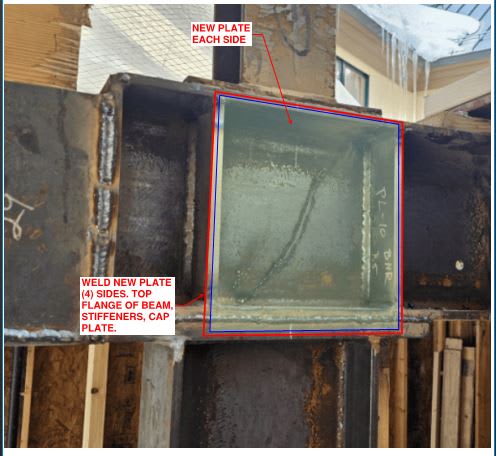

I have a connection that the contractor was unable to bolt because of a field alignment issue.
It is a moment connection. Their solution was to add on this
external horizontal weld line. I'm not understanding how the weld can penetrate if
there is no bevel on one of the plates (or bottom flange). I see a single pass of 1/4 inch weld....but
I'm just thinking that most of it is just globbed on the side of the flange and column cap plate.
Thoughts would be appreciated.

Grind the weld smooth and weld a plate of same web thickness all around, top and bottom flange and back to the web.

If understand correctly, I like JedClampett's idea of adding new web material. Jed, is this what you meant:
This will get you some moment transfer, not sure if it is enough. Also not sure how critical your misaligned stiffeners are.
Yes. You even put a little more than I envisioned.
On the penetration question- you'll get some penetration regardless. If a specific amount is needed, it would be possible to gouge out first, then weld. If you have full-time weld inspection on the job, that inspector should be aware of what was done.

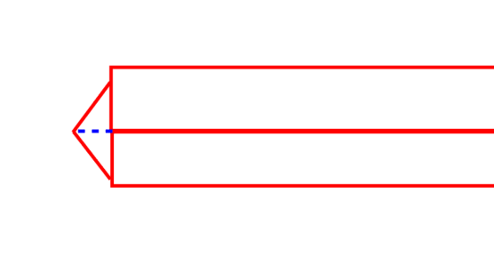

Youve said it all, you cant have a fillet weld without some throat, and you cant just create a throat on the outside of two flush plates. What a mess
I think you potentially *could* have a fillet weld style weld in this kind of location. It's just wonky as hell. If you had someone build it up properly, there's a potential throat where the blue line is. It would be really sensitive to prying actions if there weren't balancing welds elsewhere but there is a throat and a load path.
There isn't enough material build up in the picture to give any significant capacity even if this were something that you should ever do.
