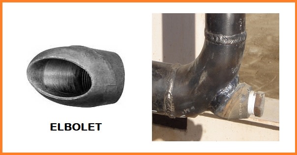

Please find attached an image of my current project. Please advise if the weld-o-let shown in the image is allowed. I could not find any details from ASME or other standards. The elbow size is 16" LR and wel-o-let is 16" x 1". Any evidences if it can be done will greatly be appreciated.

It's certainly not usual as there will be some curvature in both directions, but I doubt you will find anything that says yes or indeed no.
Having said that, elbowlets are allowed which is just a different version of this ( a reinforced branch fitting welded to another forged fitting) B16.9 seems to sat this sort of thing falls into B31.3 piping specification area, not the fitting itself. But it's very vague.
My instinct is to say no, the elbow is a forging in all likelihood and may not have equal wall thickness.
But also on the grounds of workmanship and potential fouling of the studs and nuts on that main flange. So either put it in the middle of the elbow or on the next straight bit.

Elbolets are used on elbows.
Correct, but this a weldolet.
Weldolets are also used on elbows, in the configuration shown above.
Does the Code allow this practice? No, I think not. The elbow is likely considered an unlisted fitting now.
Is this method used more often for Code applications, without further/additional calculations? Yes, I think so.

Elbowlet? No, not here for this application. Those are shaped to go into the extrados "outer curved side" of an elbow to "poke a hole into the pipe" that will be "aimed" at the axial centerline of the inlet or exiting pipe attached to a 90 degree elbow. Here, the weldolet is "aimed down" into the radial axis of the elbow.
Agree, the elbow fitting is altered; hence, it needs to be qualified.
Yes, i have observed locations where fittings are altered, whether or not the fitting was qualified, i have no idea.
Fyi, elbolets are made for this purpose.
