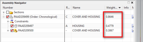

I have several Parasolids that I have assigned material to and need some guidance on how to get the overall weight. Can someone please point me in the right direction?
Are they all in the same Assembly?

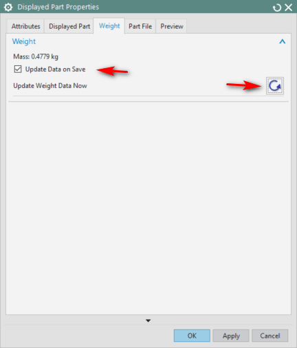

You first need to make sure, in the properties of each component, that the "Update Data on Save" is checked.
Then you can see, in your assembly, the total weight of your structure.
