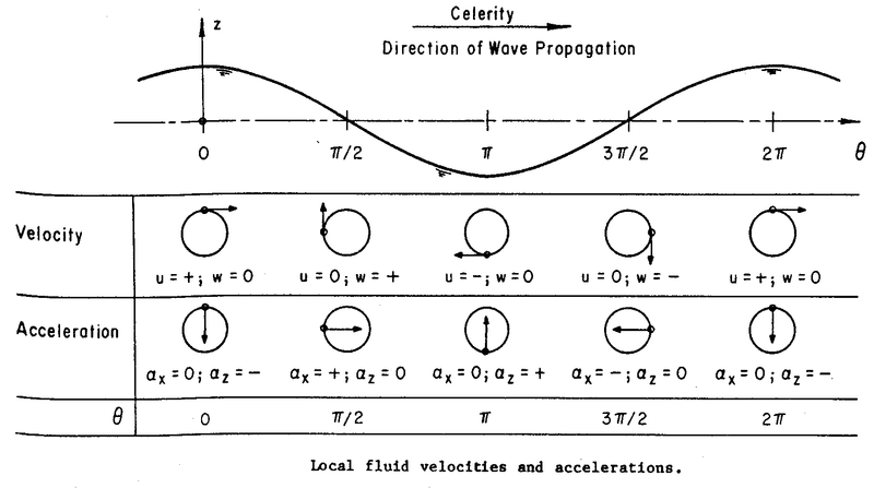

With wave loads, is it a real thing that forces are equal in the opposite direction with a phase difference of 180°?
I saw this diagram online.
So if you had a structure much longer than the wavelength, would the net load be zero?
Or is that velocities/accelerations are higher for the phase 0-90°?
Of course. They are real as covid 19.
The applied wave force is equal in both directions and algebracially sums to zero.
The structure to which the wave is applied may not experience equal loading in both directions, because the wave is higher at 0 and applies its load to a greater height of the structure.
Don't forget the current load. Design conditions are usually applied with a simultaneous current loading. The combination of wave and current will make the load in one direction considerably higher than the opposite. If waves and currents are considered to be omnidirectional, as more often than not, the net effect on the design of the structure may ultimately be the same in all directions.

Note that your diagram is for linear Airy wave theory, mostly valid for depths greater than 1/2 the wave length. You must use different wave shapes for lesser depths and where waves are subject to shoaling effects.

In the context of a wave cyclic load, the velocity and resulting drag is first applied in one direction through Π/2 - 3Π/2 then reverses for during 3Π/2 - Π/2. Net orbital particle velocity at any depth is zero, but the drag vectors applied load to the structure are not zero, because the position of the load vector applied to the structure raises and falls with the height of the wave. But drag load is the same for equal velocities and drag sums to zero as there is no net movement of any water particles between cycles. The load vector components applied to the structure are sinusoidal functions, as are the vector's placements.
A cork (length =0) floating on a pure Airy wave, with no superimposed current, will orbit, but not experience any net movement forward or reverse,
(Assuming the structure is exposed to full wave height...)
A structure with length equal to that of the wavelength will have equal drag force applied in both forward and reverse directions at any given time.
A structure of half wavelength has a net forward force for a time equal to 1/2 the waves period, then a net reverse force for the next half period.
However those forward and reverse drags always create an overturning moment because the height of the wave applies the forward and reverse components at different heights.

What prompted me to ask the query, was that I was observing someone else's output from what I think was a Stream Wave calculation and I think it showed velocities and accelerations only for the first 90°. After that it was Zero. I don't know if the range was 0-180° or 0-360°.
The structure I had in mind was a jetty with piles. Some piles would have forward forces, some in the other direction (this is what I'm not sure of). So hypothetically, if jetty is long, and piles were at a smaller spacing than wavelength, then was net zero? I do understand the part about the current, in this scenario it was assumed there is no current.

LR11, you are correct that not all piles will experience the maximum load at the same time, and some will have reverse loading. The overall lateral system doesn't need to deal with a simple sum of maximum force on a pile multiplied by number of piles. If the jetty can experience side-on waves (wave crest parallel to the jetty), the effect would be fairly marginal, but the dominant wave crest is oblique to the average jetty.
For pile-size elements, drag is probably dominant rather than inertia, so my earlier comments not so useful to you.
A jetty is also quite likely not in deep water as far as waves are concerned, so the Airy (linear) wave theory not quite correct as 1503-44 said before.

The other three quadrants can be determined from the first quadrant for linear wave theory (mirror and/or negative of the first quadrant), so maybe only the first quadrant is calculated.
