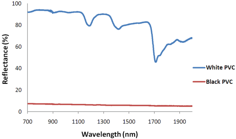

@Compositepro From what I've read, only IR enables heating when absorbing solar radiation. See the following in the section on infrared light. UV and visible can cause chemical reactions for photosensitive chemicals, but not heating.
From your graph, since reflectance is the complement of emissivity for opaque materials (where transmissivity = 0), we can say, for UV stabilised black HDPE, e = 1-0.1 = 0.9 over the IR wavelength range ( assuming r remains at 0.1 in the far infrared also). And absorptivity is more or less = emissivity for most materials (Kirchoff's Law approximation). And 0.9 inferred from this graph is close enough to the 0.8 value used previously in the calcs.
If the visible reflectance is less than 100%, then visible light is absorbed, and that equates to heat; even white PVC is not 100% reflective in the visible, so it will get heat from visible light
TTFN (ta ta for now)
@IR, thanks for that - agreed, something must happen within the opaque material for any light not reflected.
In the chapter on radiation in Perry, it says for polished metals, emittance in the infra red results from free electron excitation, while bound electron excitation dominates at emission in the shorter wavelengths, including within the visible range of 0.4micron to 0.7micron. And the converse must also be true for absorptance I guess.
So temp rise is 5.8degC at 1.5m/sec water velocity even for UV stabilised HDPE pipe.
