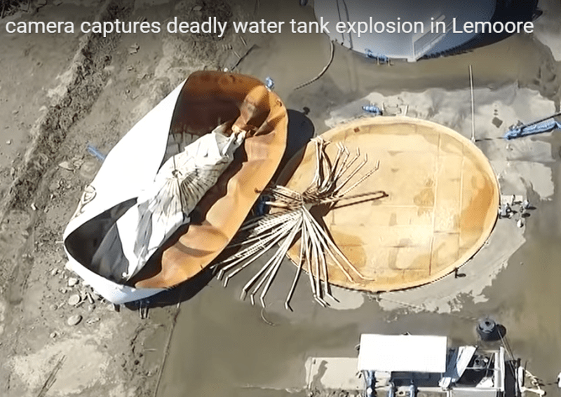

This happened in my area. I am very familiar with Lemoore and its water system because twice I was at firms that served as the contract City Engineer and I have designed some elements of that water system. My first stint was long before the Well 7 site was developed. My second stint was after the well and first tank at this site had been constructed. I helped the engineer who designed the water treatment vessels and second storage tank at this site sort out some piping connections, but I can't tell you if it was the older or newer tank that just blew up and my records are in storage.
Apparently, someone was welding something to the outside of the tank and it sparked flammable gas inside the tank (that's what the City's Public Works director speculated about in an on-site interview I saw online). This tank appears to have had a good amount of water in it, so I'm having trouble understanding how a flammable gas got into the headspace of the tank. More details will certainly come in the next days/weeks/months.

Dissolved natural gas in the well water?
My last home was on a 500 Ft. deep well and we got a lot of natural gas.
At times the taps would spit gas instead of water.
It could be lighted and a ball of flame would rise up towards the curtains.

Almost certainly dissolved natural gas collecting in the tank.
The City of South Houston blew the roof off a tank years ago with a similar scenario.
On a tank that size, it would be expected to blow the roof off rather than pulling the tank loose from the bottom. It makes me curious if they had the roof beefed up for some reason.
One thing I notice that welders universally don't understand is that the smoke generated from coatings inside of a tank during welding isn't actually smoke but vaporized hydrocarbons resulting from pyrolysis. If there was a substantial amount of welding happening or the tank coating was smouldering I could see a building of flammable gasses.

I don't know how deep Well 7 is, but I'll bet it's a deep one like the one I designed. If so, it might just be picking up methane too. From the pics and videos I have seen, it appears that the remaining tank (which I now think is the older tank) has only one static vent. I had recommended to the design team for the new tank and the treatment vessels to install a turbovent on the tank and additional static vents, but I left the firm before the plans were finished so I don't know what the final design looked like. A turbovent is just like you see on house roofs, just larger. My boss in the early 1980s came up with this idea as a way to help "pump" humid air out of the headspace of tanks to reduce corrosion, but it should also help for methane build-up. Over the years, I have used turbovents (mostly Romlair) on all my tanks. IIRC, the smallest turbovent I have used was 18" and the largest was 48".

As I recall, this tank had a knuckle roof, so the weakest joint would have been floor/shell. If it had had a cone roof, I think only the roof would have blown off.

In the aerial footage of the tank afterwards, the only thing resembling a bag is the roof plate.
This whole thing is a well-known effect in petroleum tanks, and there have been a number of cases investigated by the Chemical Safety Board that were similar.
One similar launch caught on video was at a tank fire in Lamesa, smaller tank, but similar effect: The problem here is that people don't expect anything flammable in the vapor space of a water tank, so they don't take the precautions they otherwise would.
Methane in groundwater is not explosive, but when water with dissolved methane comes into contact with air, the methane escapes from the water. If this occurs indoors or in a confined space and the level methane in the indoor air reaches 5%, there is a danger of fire or explosion.

It was just the white shape which confused me but this could easily be a liner, though the interior walls do look quite rusty so maybe the roof has inverted.
The video seems to show the roof bulging outwards as it moves upwards to an unbelievable degree. and then lifts off.

I think the interior ceiling of the tank is painted white like the outside. You can see that where the white roof ribs touched the ceiling, there is no white paint

For a knuckle roof tank like this one, the weakest joint is the floor/shell joint. For a cone roof tank, it would be roof/shell. Here, the weight of the water kept the floor in place and the floor/shell joint broke due to the upward explosive force.
--Winston S. Churchill
SwinnyGG...
That's the roof and shell that are upside-down, still attached to each other.
Right.. that's exactly what I said. The tank walls and roof are mangled and upside down next to the floor of the tank which is still sitting where it was originally.
