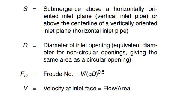

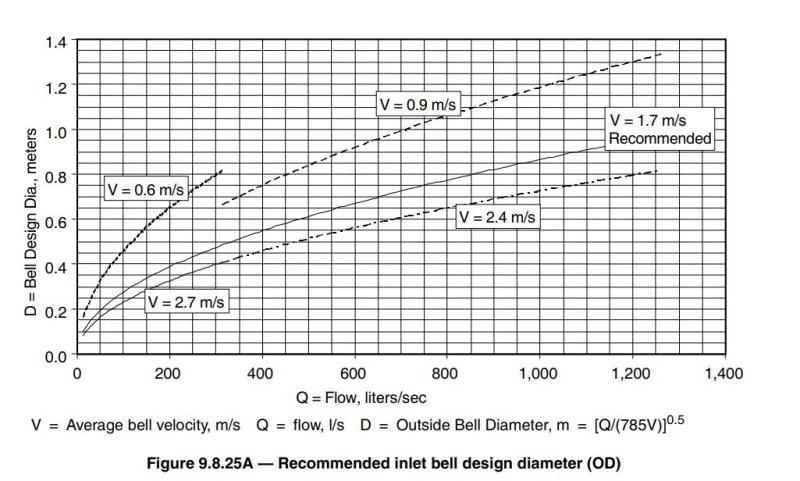

Based on the above, the thinking has been to calculate the velocity at the "cylinder periphery" of the bell mouth.
However in the Hydraulic institute document mentioned above they mention the velocity at inlet face.
[URL unfurl="true"]https://res.cloudinary.com/engineering-com/image/upload/v1711365799/tips/Bellmouth_sketch_aeuvbz.pdf[/url]
They further suggest an "recommended" inlet velocity of 1.7 m/s. If that is 1.7 m/s at the face, as per the hatched section in the hand sketch, what is the velocity going to be in the "straight section of the pipe?
If I apply the area formula of a 185mm dia bellmouth the area is 0.0268 m^2.
If I apply the area formula to the cylinder dia/height, the area is 0.0537 m^2.
Both would produce a vastly different velocity.
Confusion reigns.
Your collective assistance would be appreciated.

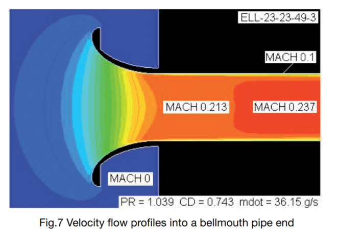

Bellmouths are definitely a bit odd and no bellmouth is the same so without a diagram I think you're lost.
The flow transitions from laminar to turbulent as the diameter reduces and takes a little while to become fully turbulent.
"Outside Bell diameter" / "Bell design diamter" is very vague and if your bellmouth essentially ends up with a horizontal edge then where is this diameter?
If you look at the attached figure 7 (I know it's air, but the same will apply for water), you can see the constant inlet velocity is a parabola. This though doesn't account for the fact that you have a wall / floor in place which buggers things up even more

Very well expressed. And as you state the diagram is for air, but the same principle applies to liquid.
To add to my problem, there is a 90 deg bend at the Mach 0.237 mark. So another change of direction and more turbulence. Then a change in diameter (100 to 200mm) and then the flow is presented to the inlet of the pump (on another 90 deg long radius bend). So little hope of "steady flow". Result = pump not achieving expected flow?
