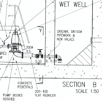

Hi all,
I have a number of sites where the pipework was sized to cater for a flow on the day. Thanks to growing populations, the station needs to be upgraded.
It's easy to increase pump and pipe sizes "in-station" to cater for the increased flows. However what is often ignored is the pipework through the wetwell/drywell wall. and by association the bellmouth in the wetwell.
There are industry standards stating the clearance between the underside of the bell mouth and the wetwell floor. Typically D/2 to D/4.
Invariably what happens is the "100mm" pipe through the wall had a bell mouth with a clearance of (Bellmouth OD - 185mm/2 = 92.5mm underside clearance).
The station is upgraded to a 150mm (pipe through the wall) in station. So the bellmouth should have a clearance of (Bellmouth OD of 245mm/2 = 122.5mm).
But the pipe through the wall and bell mouth were not upgraded, so we have a 100mm pipe/bellmouth with a 150mm velocity.
The question is, does anyone have the formula for the calculate the annular velocity entering the bellmouth.
Thanking you all in anticipation.
Nutzman

Hi LittleInch,
Thanks for coming back to me. Attached is a snapshot of the drywell/wetwell. In this instance the pipe diameter has gone form 100 to 200mm. Essentially what should have been done, was the wall, should have been core drilled to suit the height of the 200mm bellmouth clearance height.
In answer to your question, i am trying to determine the velocity entering the bellmouth (between the floor and the circumference of the bellmouth.
In the above example the initial bellmouth is 92mm above the floor. If a 150mm pipe was fitted the clearance should be 122.5mm thereby maintaining acceptable inlet velocities. But with the clearance still been 92mm and the increased flow to accommodate the "150mm" flow the velocity will increase. Hence looking for a formula to calculate the circumferential velocity (or annular> Perhaps my terminology is not correct)

The annular area I believe would be equal to:
A = Pi*(D)*(Clearance)
If clearance was equal to D/4 then:
A = P*(D)2/4
or the same flow area of the diameter of the bellmouth. For clearance = D/2 then annual flow area would be equal to twice the flow area of the bellmouth. So it looks like the rule is to maintain 1 to 2 time the crossectional flow area of the bellmouth in the annual inlet area (which gives 0.5 to 1 times the bellmouth crossectional area velocity).

I don't think the cylinder idea is correct.
If the distance to the floor was say 4D, there's no way you would get an even velocity across that imaginary cylinder.
I think it's more like a cone where the base is the bellmouth and the depth is that D/2. In you case that cone gets flattened a bit. Losses will increase if you double flow. If this is an issue why don't you unbolt that elbow and bellmouth and install something bigger and different? The wall coring is prob too much effort, but you could modify the pipework in the wet well no?

Essentially what i am trying to determine is the increased velocity coming under the bellmouth, due to the bellmouth/pipe through he wall not been upgraded when the pump and in-station pipework is upgraded.
On the stations I have come across thus far that have not had the bellmouth pipework upgraded they all fail to achieve required/expected flows.
I've checked for minimum submergence to ensure their is no vortex.
But the higher velocities and turbulent flow presented to the pump suction is inhibiting flow.
In terms of wall coring, without increasing that diameter through the wall, the original pipe becomes the pinchpoint. (higher velocities).
If there were enough room within the drywell, the pumps could be moved back and the suction pipe extended, to accommodate the 5 x diameter. But the station was build decades ago, to suit the equipment of the day.

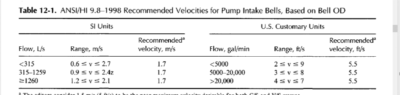

Suspect you may find guidance on this from the Hydraulic Institute Standards. A great deal of reorganisation appears to have taken place since the 1970s' when everything was in a single voluminous bible. This topic is probably now in a standard all of its own - see HI9.8
Hi George,
Many thanks for that guidance. I had a copy of the spec and had perused said document. It's interesting to note that the clearance between the underside of the bellmouth and floor is listed as 0.3D to 0.5D. Whereas other literature (possibly '70-'80's) state 0.2 to 0.4D.
But the Hydraulic institute document recommends the ideal velocity (across the bellmouth) as 1.7 m/s.
However in order to calculate the ~1.7 m/s there is a rather complex formula, that calls for a f = Function, Nt = Circulation number, T = Circulation (2πrVt for concentric flow about a point with a tangential velocity Vt at radius r).

Several types of pump intake basins are briefly described together with advantages and limitations for use. Dimensions are given in terms of D, the outside diameter of the suction bell of the pump. The ANSIHI 9.8 standard should be consulted.
Table 12-1. ANSI/HI 9.8-1998 Recommended Velocities for Pump Intake Bells, Based on Bell OD
Pumps are suspended (usually by a platform) in a body of water with no confining walls or other flow guiding structures. Unconfined pump intakes are inexpensive and useful for lagoons, lakes, rivers, and canals. Ice, debris, and fish that must be screened ahead of the pumps are of particular concern and require special consideration.

As per the image posted earlier, the site was a wetwell/drywell installation.
On further investigation it appears that although the line velocity in the pipeline through the wall is within the above limits, the lack of 5 to 10 times pipe diameter straight before the pump suction (in order to allow the liquid flow to become stable), including 2 x 90 degree change of direction (in the same plane), collectively contribute to the pumps poor performance. Along with a borderline size of rising main and possible air release valves not functioning properly. So yes, a whole cocktail of issues to consider.
