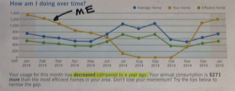

Here is my chart. Energy star appliances, heat pump water heating, CFL and LED even use a wall switch to to turn off TV. Still I am double my neighbors. The energy sucker is the hot tub. At least I do good in the summer!

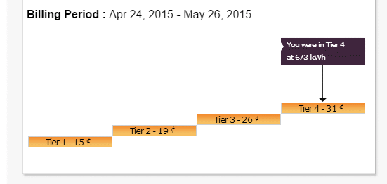

$0.31 per kWh. Ouch. Our rate (Nova Scotia) is about one-half of that. $0.14-something.
Worse than that, the Tier 1 allowance would only be sufficient for running the PVRs.
I'm not sure exactly what rate tariff is assumed for the Canadian EnerGuide labels when they provide dollar estimates for annual energy consumption, but it's a bit lower than ours. The $0.10 was a guesstimate.
My house uses simple electric baseboard heaters, but it also has about 24 sq m (!) of south facing glass (passive solar, very well insulated). My annual space heating cost is about the same as my Internet + telephone cost for a year. Not insignificant, but certainly affordable.

VE1BLL: be careful, as you need to actually break down all the fees and charges. The bills here are deliberately confusing, so I suspect the utilities in Nova Scotia are no less sophisticated in subterfuge!
Here's a breakdown of my Toronto Hydro fees:
Basic rates: this is what everyone THINKS they're paying for power:
On-peak: $0.161/kWh
Mid peak: $0.121/kWh
Off peak: $0.08/kWh
Fairly high, but not so bad compared to California!
...but then there are the fees:
transmission losses: multiply kWh used x 1.0376
transmission charges: $0.014/kWh
distribution: $0.015/kWh
regulatory: $0.005/kWh
debt retirement: $0.007/kWh
customer charge: fixed fee, works out to $0.014/kWh for me over a typical month.
That's $0.055/kWh in fees, plus the 3.76% multiplier for distribution losses
Then there's 13% HST on the whole works- yes, that's a real cost, even though it isn't hidden in the price like it is in gasoline at the pump.
That works out to roughly $0.20/kWh all in, average of on peak and off peak. That's the figure I use for comparing cost savings from efficiency or offsetting with rooftop generation etc. Lots of options pay back at $0.20/kWh. What depresses me is that the microFIT contracts for solar PV pay people $0.50 or so (it was previously $0.80) per kWh for all the power they generate from their rooftops, even if not a single electron in fact leaves their houses and enters the grid...those FIT programs should only be for net excess power generated.
