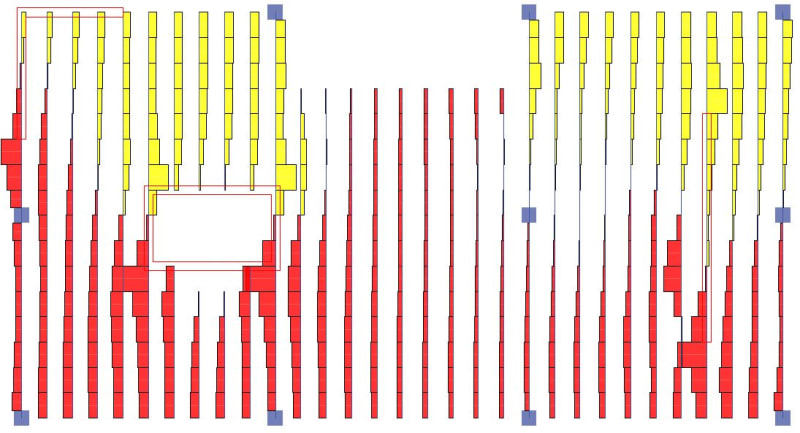

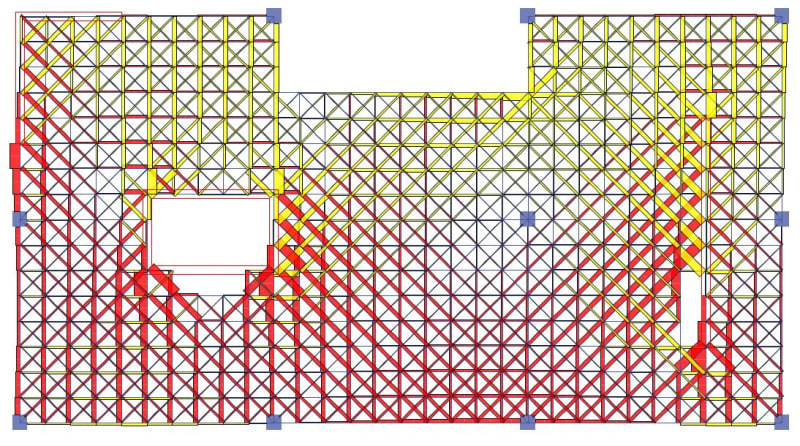

Interesting... so instead of a continuum of shells it uses a continuum of frames. It would be intriguing to do a side by side comparison, how much of the STM v FEA comes out in the wash when you vary the grillage/mesh size.

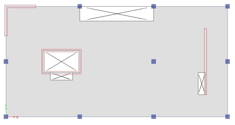

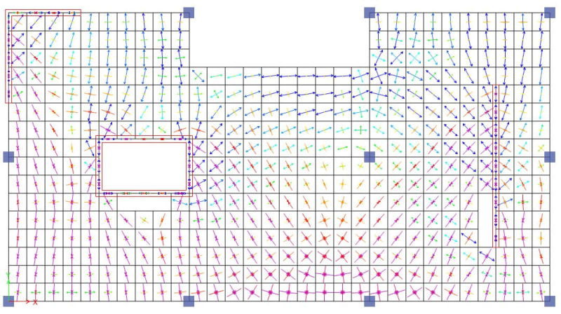

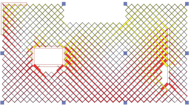

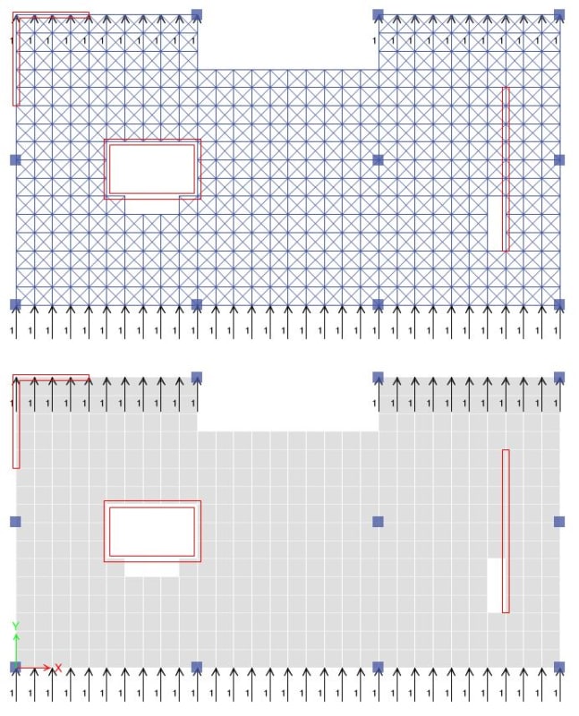

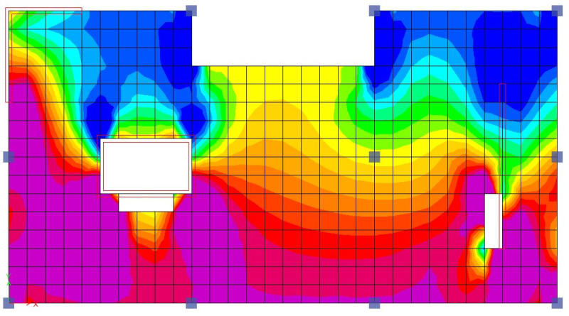

I've come up with a basic example, which I would like to test using a 1m mesh/grillage size.

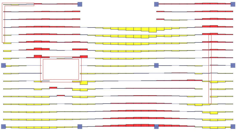

Axial
Axial F12
Axial F11
Axial F22
F12
F11
F22
FMax
You'd apply your 1kN loads distributed to all the internal nodes, you're trying to represent the distribution of mass and hence diaphragm inertia. You wouldn't model walls and columns, just add reaction loads from your global pESA model to capture the transfer forces. Then run with some weak springs to restrain model in each degree of freedom at selected locations.
Is this in accordance with the capacity design approach though?

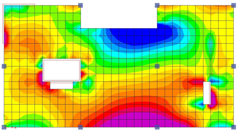

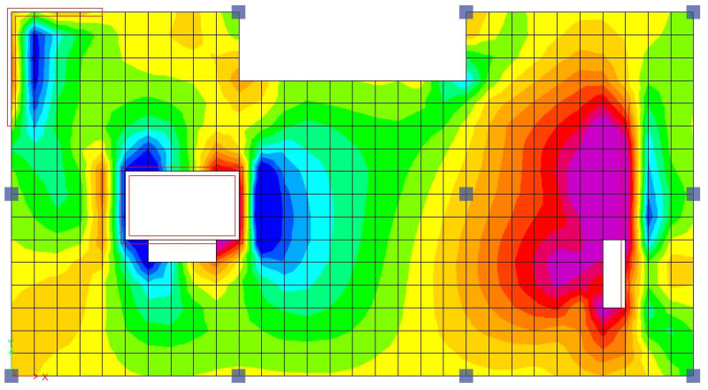

I see no reason why the approach wouldn't give the same results as FEA (in general)
The pESA loads are derived based on the overstrength of the building and or a minimum peak ground acceleration which usually governs in the lower levels. Each floor is looked at in isolation. You don't model floors in your global analysis using this approach.
The point is it is intended to result in an envelope of forces that captures the peak transfer and inertia forces within the diaphragm. A normal response spectrum or equivalent static analysis won't capture this. You'd otherwise need to do a time history analysis to get this information. The other benifit of doing it this way with existing structures you can tune the mesh location and also stiffness to capture the redistribution of loads or where the reinforcement for drag elements has been placed via an iterative approach. You cannot do this with a shell model, the load goes where the stiffness and mesh size says it goes. Generally extracting relevant information from a shell model is not easy, and you'll come across the issue of peak stresses at discontinuities not representing any actual loading or loadpath. A shell can also carry tension on the diagonal, there's no easy way to say a strut is a strut for example.
