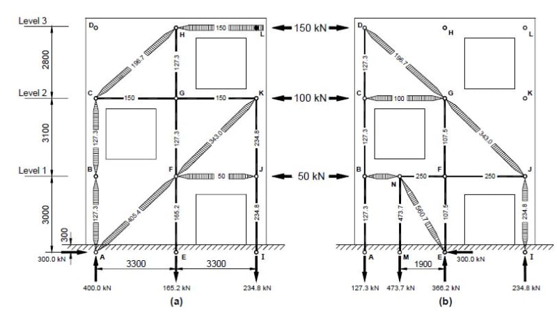

AS3600-2018 states that walls to be designed as strut and tie when H/L > 2. Can anyone walk me through how to design shear walls as strut & tie? Some examples will be great.
I understand how to design pile cap or deep wall (or beam) as strut and tie under gravity. But how do I design walls as strut & tie for lateral?

As retired suggests, I think the principle will be the same. You'll have a compression strut and a tension tie with node zones at the intersections.
You'll end up with a two member truss in the wall. Apply the lateral load at the top corner, and draw a line down to the opposite bottom corner. There's your compression strut. Your tension tie will be vertical from your applied load down to the foundation.

For a strut and tie design example for a wall with openings have a look at the example here in section 3.8. Same concept can be followed for walls without openings.
Its related to masonry, and NZ standard. But should give you some guidance.

It definitely has its place with regard to demonstrating local loadpaths around discontinuities, openings and so forth where normal code equations cannot be applied verbatim. Basically where ever you need to think what is the Loadpath here, you should be considering strut and tie, even if it's just to gain a feel of where the load is going.
Corbels, beam column joints and more importantly diaphragms all make use of strut and tie round these parts on a regular basis.

In the example that Agent666 linked to they just apply the distributed horizontal loads as a point load at the edge of the wall and develop the STM from there.
Just distribute the load between the nodes in some logical manner (usually tributary length between nodes at floor level. Ensure the connected floor can deliver the load in this manner.

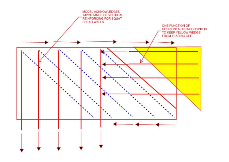

1) I appreciate your honesty and suspect that is most people's truth on this. A true, formal STM design exercise is often very onerous given current technology. There are times when it's appropriate but, as you probably know, production engineering has to move quickly. Most things need to be ETABS / Excel in order for anybody to make any money.
2) In some jurisdictions, such as my own, there are provisions for Squat Shear Wall Design. This follows a model similar to that shown below wherein:
a) It is acknowledged that a squat shear wall behaves differently from a slender shear wall where conventional, flexural design treatment is appropriate.
b) It provides designers with an appropriately expeditious tool for the design of squat shear walls that is amenable to spreadsheet / software solution.
I've been referring to solutions like this as "Strut and Tie Informed" and a lot of practical design techniques go this way in my experience. You're basically acknowledging the salient features of a strut and tie model without getting waste deep into the weeds of it.
