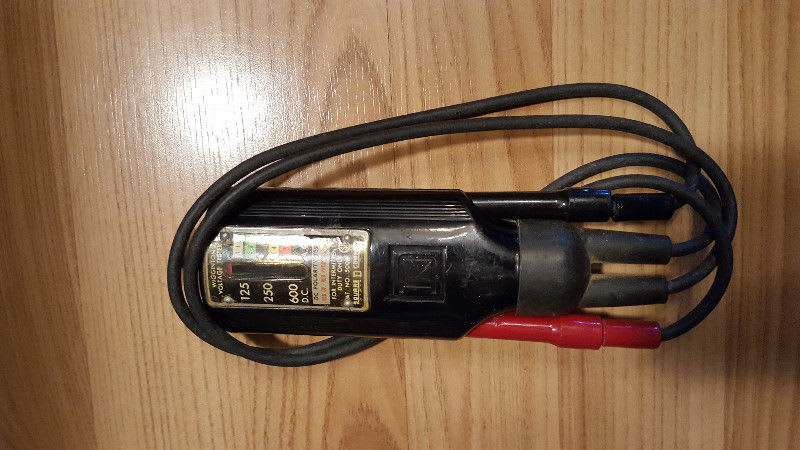

I would use a neon tester like this one or similar to check from the motor case to earth.
Amprobe PY-1A Voltage Tester
This style tester significantly loads the source and if it's capacitive in nature you will see a large difference between the Fluke and the neon tester. Hook the fluke up and while watching it use the neon tester. If it's capacitive, like I suspect it is, the Fluke reading will plummet.

Better yet use a Wigginton Voltage Tester. AKA "Wiggy"

Bill, almost every time I mention using a Wiggy (or its sister, Knopp) lately I get blank stares from anyone under the age of 50... they have no idea what they are (were). Fluke (and their offspring) have effectively removed them from the vernacular it seems. Pity.
It's on Wiki under Solenoid voltmeter, Jeff.
George Wigginton patented the Wiggy 100 years ago.
Wiki said:
Solenoid voltmeters are extremely rugged and not very susceptible to damage through either rough handling or electrical overload.
For "go/no go" testing, there is no need to read the scale as application of AC power creates a perceivable vibration and sound within the meter.This feature makes the Wiggins tester very handy in noisy, poorly illuminated, or very bright surroundings. The meter can be felt, the more it jumps the higher the voltage.
Solenoid voltmeters draw appreciable current when operating. This makes them useful for testing residual-current devices (GFCIs) because the current drawn will trip most RCDs when the solenoid voltmeter is connected between the live and earth conductors. Also, when testing power supply circuits, a high-impedance connection (that is, a nearly open-circuit fault such as a burned switch contact or wire joint) in the power path might still allow enough voltage/current through to register on a high-impedance digital voltmeter, but it probably will not actuate the solenoid voltmeter. For use with high impedance circuit applications, however, they are not so good, as they draw appreciable current and therefore alter the voltage being measured.
