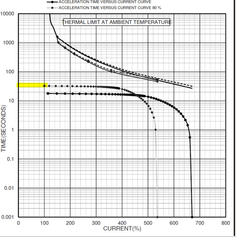

I just had another question and would be appericated if you can help. I was wondering is acceleration time vs current curve doesn't consider load torque?
Because based on the Torque vs RPM curve for motor and load, i was able to calculate the acceleration time. The acceleration time of 80% voltage with load toruqe considered is 44s and 32s for without load torque. And when I check the acceleration time VS current curve, it seems like the t is around 32s which means the acceleration curve is for without load torque condition. But most source i found online indicate this curve is with load torque considered. I am a bit confused.
Calculated using data of 2255 kW/1200 rpm [6 poles] Siemens production for load inertia of 1600 kg.m^2
[approx. 6 times motor inertia] the starting time for 100% voltage supply is 21 sec and at 80% it is 33 sec.
