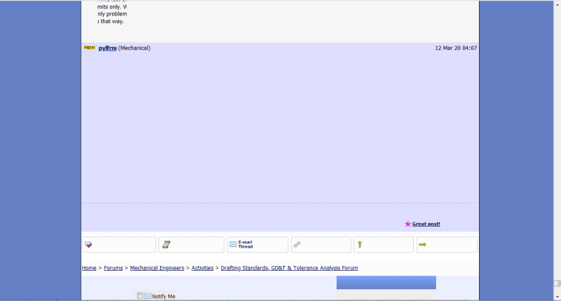

This was the formatting:
[ignore]
⌀5.0±0.2 THRU
[box]⏤[/box][box]⌀1.0Ⓜ[/box]
[box]⌖[/box][box]⌀0.5Ⓜ[/box][box]A[/box][box]B[/box][box]C[/box][/ignore]
And this is how it looks for me in Firefox:
What is it doing on your end?

I just restarted Firefox and it feels much better now. I had gone to Chrome and the "straightness character was blank there as well, though marking it for "search with Google" showed it was straightness. Reloading the page a couple of times in Chrome finally fixed it. I wonder if the problem in both cases is that the browser was forced to search for the unicode characterset that matched that entry and both of them failed to do so. I expect the browser at your end had already encountered the in-line character because you were the one who posted it. Not so much always WYSIWYG as sometimes WYSIWTF.
This is what I was seeing:
