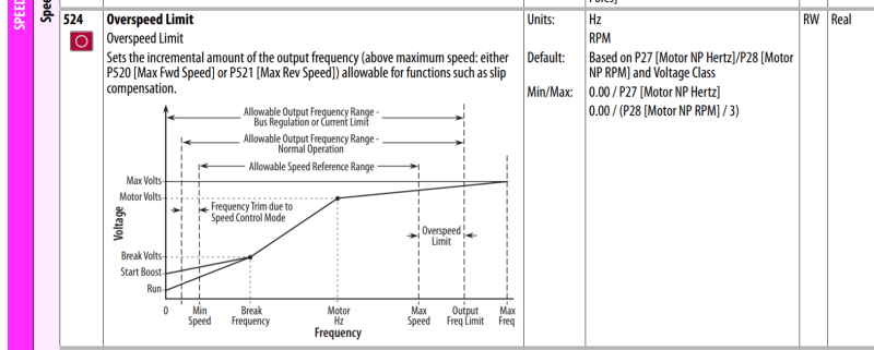

Overspeed setpoint is only 10 rpm different from max speed.
And max speed was to 3000 rpm or was that overspeed?
and after only 2ms.

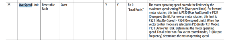

From above manual

There are different parameter settings for forward and reverse, that effects the alarm 25 OverSpeed Limit.

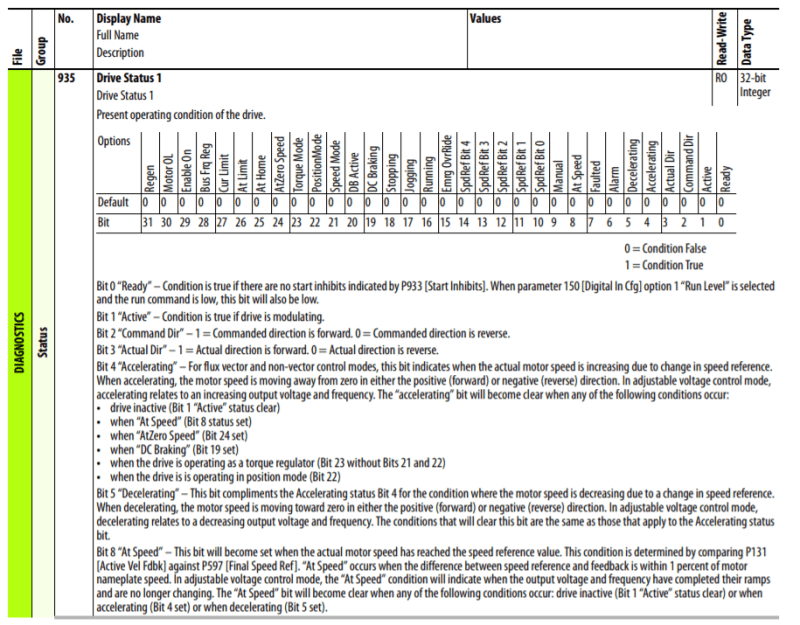

Can you access this status word on the panel ?
If so you should be able to see the motor direction in bit 2 and 3 if you test drive it.

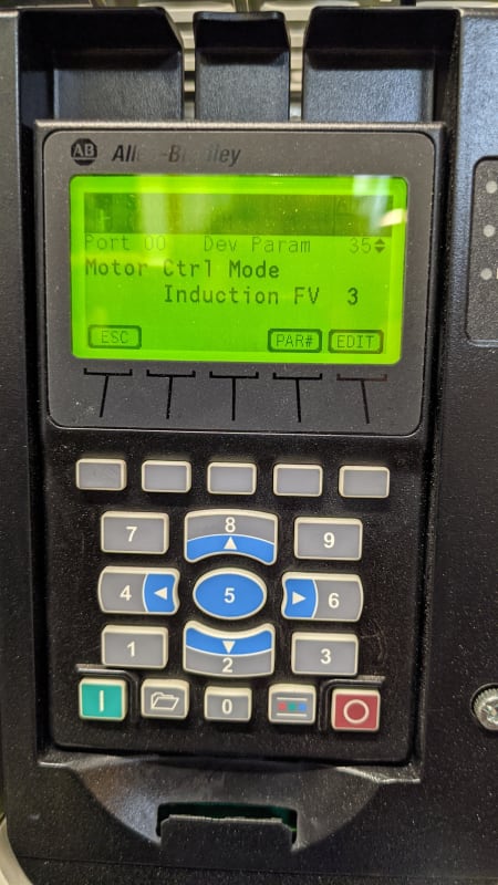

If I am looking in the right manual there many different types of vector controls.
So if it possible to look at parameter 35 in the panel it would help.
/A
Albert Einstein
35 Induction FV (3) – Induction motor, flux vector control mode [thumbsup2]

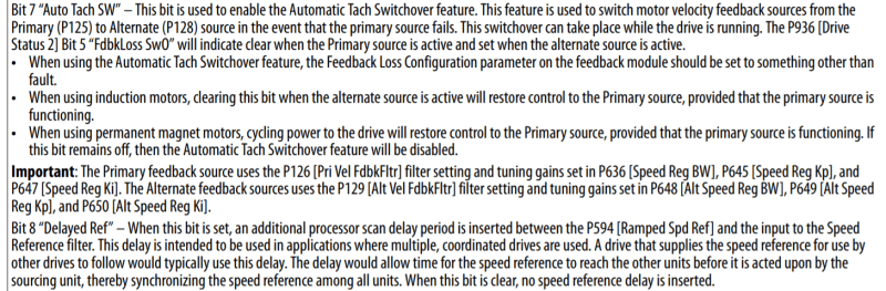

Inverters with this many parameters usually have a read out option on the panel so you can go through the parameters that are changed from factory settings.
It is almost impossible to give advice without the basic settings at hand.

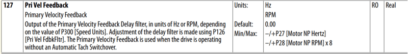

There seems to be a function that is called Automatic Tach Switchover, what governs it I do not know but it is used to use different feedback sources or filters, if the encoder is broken and this is used it can start using other parmetersets then it usually uses.
Par 635
BR A
Albert Einstein
Some parameters to look at for this function.

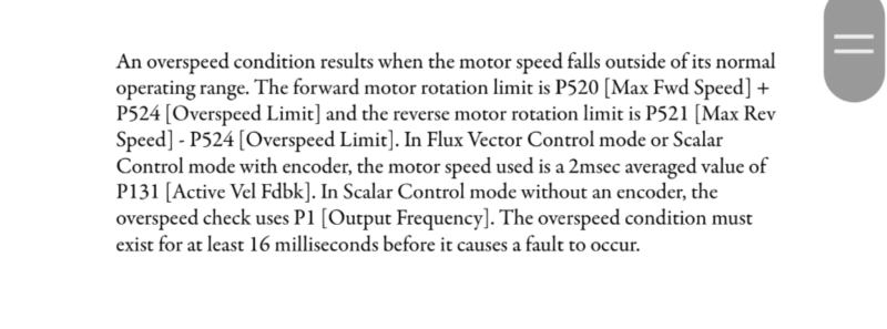

Par 953
Bit 7 “Overspd Lmt” – When set, indicates that a F25 “OverSpeed Limit” fault has occurred.
This is a non-configurable fault. An overspeed condition results when the motor speed falls outside of its normal operating range.
The limits of this range are established by P521 [Max Rev Speed] - P524 [Overspeed Limit] = (lower limit) and P520 [Max Fwd Speed] + P524 [Overspeed Limit] = (upper limit).

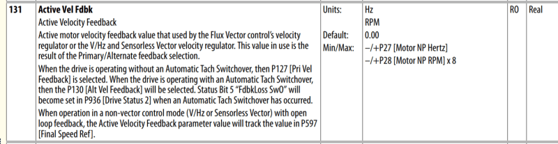

In flux vector control mode or scaler control mode with encoder, the motor speed used is a 2 msec averaged value of P131 [Active Vel Fdbk].
The overspeed condition must exist for at least 16 milliseconds before it causes a fault to occur.

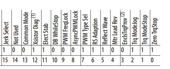

Motor Options Config 1001 1000 1111 x111

Par 40 Motor Options Config 1001 1000 1111 x111

[highlight #EF2929]Bit 14[/highlight]
Bit 15 “Jerk Select” – Limits the rate of change to the velocity reference for improved current limiting. This setting applies only to Sensorless Vector and V/Hz motor control modes. [highlight #8AE234]1 = Enabled (0.0 second ramp time prevented)[/highlight]
You might want to look at bit 12 and bit 15.
bit 15 is what waross was taking about earlier, it smoots the speed in the corners when going from acc/deacc to continues speed this makes it run without "pulls and jerks" which can create "folloing errors / overspeed faults"
