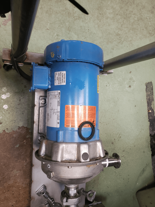

Hi all,
I am in the brewing industry and I accidentally purchased a Goulds pump that was meant for 50Hz service (typical for Europe but not USA). I unfortunately cannot return it so I was looking to find out if I can use a VFD to control it's speed or at least bring my 60Hz service down to 50Hz.
I have plenty of experience with VFD's I have several currently in use within the brewery. But they are all used with 3-phase power and 3-phase motors.

The motor I purchased is this one:
I was wondering if anyone could tell me which above category (or other category) this motor would fit into?? Beware the photo on the website is not the actual product photo. This motor does NOT have a capacitor. I attached my photo of the actual product, you can see there is no capacitor. I appreciate any info y'all might have!
The capacitor for your motor is likely secured under the shroud end or back end. Removing the cover will reveal the capacitor.
It also looks like the motor is rated for either 50, or 60 Hz operation. (Based on the attached photo.)

Suggestions:
Forget the VFD.
Run the motor on 60 Hz.
To maintain the V/Hz ratio, use an auto-transformer to boost the voltage up to 265 Volts.
1.> Redneck solution. Throttle the discharge to bring the current down to or below the nameplate current rating.
2.> Trim the diameter of the impeller so that it is suitable for use at 3500 RPM.
3.> Contact Gould and request a replacement impeller that is suitable for 3/4 HP at 3500 RPM.

No need for a transformer.
Try it and watch the current.
Look at impeller solutions if the motor overloads with the present impeller.

What is the actual problem you are trying to solve here? The motor is rated for 50or 60Hz, it of course spins 20% faster at 60Hz, so the pump will move more fluid and require more HP to do so. But that then depends on how you sized it in the first place. As Bill has said, you can probably just restrict the flow and get the same net effect as reducing the speed to 50Hz.
Keep in mind, 3/4 horsepower motors here in the USA are ~$350 so you don't have much room to work with before you exceed the cost of simply buying the right motor.
If you buy the same frame motor in 3-phase and hook it up to a cheap VFD it will absolutely work.
Buy a single phase VFD for a fortune and it might work..
I'd just replace the wrong motor and sell it.

Thanks everyone for the input. Yeah it says running at 60Hz will reduce the life of the motor. It's only going to be used for an hour or each week so I suppose a valve on the output would work fine to throttle the output down.
It is for wort (beer before it has alcohol) so I don't really like the idea of always running it full speed because excess oxidation of wort is possible with the thrashing of the impeller, but as you guys pointed out, it would probably be a MUCH more expensive solution to actually get this thing running with true VFD control.
