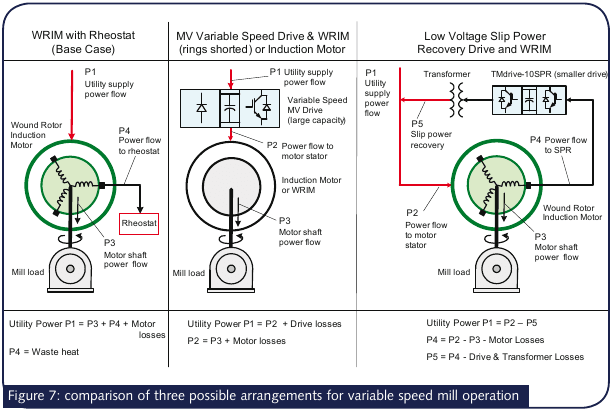

Slip power recovery scheme (SPRS) have a potential for high energy recovery, with an overall system efficiency better than inverter drive and motor. Of course realizing better efficiency is going to be in the details of the two drives applied to your specific motor.
(Attached)

There is power being lost if there is rotor resistance in the rotor circuit, which isn't clear if it's there or not in your description - "rotor resistance manipulation".
That would be a big drive though, so the payback might not be there.
Lionel
They start using the rotor resistors to bring up to rated speed whence the SPRS take over bypassing the resistors.

Energy savings on VFDs stem from eliminating losses created by mechanical flow control devices such as dampers. If you are using a WRIM with a slip energy recovery system, it is already a variable speed system, so there will be no energy savings by switching to a VFD. I wouldn’t do it.
It's not worth switching if they are recovering the rotor energy back into the power system.

The point in time where a VFD conversion decision could be economically viable is the point in time when the SPRS unit must be replaced (technological obsolescence?). However this unit is large enough to be in the size range where some vendors offer technology updates which replace all of the components that are no longer available from the normal supply chain. Technology updates should be considerations when available.
The other reason to change is if operation outside of the speed range available from the SPRS is needed. For a power boiler application it seems unlikely that conditions could change that much.
