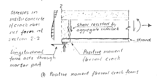

Shear capacity doesn't solve the reinforcement anchorage issue. That said, the sketch below is taken from one of the NZ seismic docs. It kind of suggests that core grouting creates a discontinuity at which flexural cracking might occur and then initiate the kind of reinforcement anchorage issue that we've been contemplating. It kind of depends on how much faith one has in the restraint relieving capacity of plank bearing strips I suppose.

Moment is zip, but there's a direct correlation between bond and shear. I suspect, with the high strength of the HC units, that plain concrete strength, plays a part of it until the strand can be utilised.
That's my suspicion as well dik and precisely what I was getting at with this, earlier statement:
KootK said:
Another thing that I know about plank is that it almost never gets taxed in gravity applications. If it did, there would be cracks all over the place and frightened villagers running for their lives. And, perhaps, the odd catastrophic shear failure.
Potential problems with that:
1) In general, structural engineers are adverse to using plain concrete for serious things.
2) It makes the setup heavily reliant upon avoiding axial tension stresses in the plank.
3) If we are going to go down that path, we should say it out loud and develop an evaluation procedure for it.

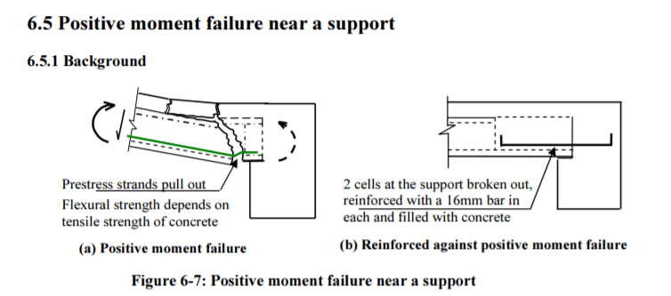

It's another glaring discrepancy that the precast associations in other parts of the world do concern themselves with this issue while we in North America do not. Are we super smart and they're just a bunch of overthinking dummies? I doubt it. I managed to find the NZ thread on this. See the comments by rapt and Agent666 here: Link
This is the paper that Agent666 sometimes references on this topic: Link. In particular, the area around the diagram copied below.

I would think the term "positive moment failure" in that diagram is incorrect.
More like longitudinal tension force/development failure leading to shear failure. I doubt Moment had a lot to do with it.
Even with no moment, there is a tension force that has to be transferred to the support, and pretensioned strand has no force developed in the last about 60-100mm and then gradually increasing from there as you said in an earlier post.
I have never understood how the PCI and industry has ever justified the design at the end of precast where they have short ledges for support.
rapt... the force in the strand is 0 for the first 3" or 4" and then develops to full tension capacity. Do you have an idea of what the tension development is? about 2'? or more?
Meh, it's just a terminology thing... and not mine obviously. That said, I kind of get it. It is the particular shear/truss mechanism failure that you would only really have IF the bottom steel anchorage were insufficient and the member was in positive bending at/near the member end. Theoretically, you could also get a top steel anchorage failure in a hogging moment scenario of course. I think that the primary difference is that top steel is almost always well anchored by default, as a result of general continuity, whereas robust anchorage often takes a deliberate effort with the bottom steel.

For .5" strand, about 5' (about 1.5m). Initial transmission length is about half of that, the rest is to develop stress above the initial prestress.
And it increases in tension zones, so could easily go up to 2m.
Where that crack was shown, the stress it could develop would be 0. So it is completely un-reinforced.
