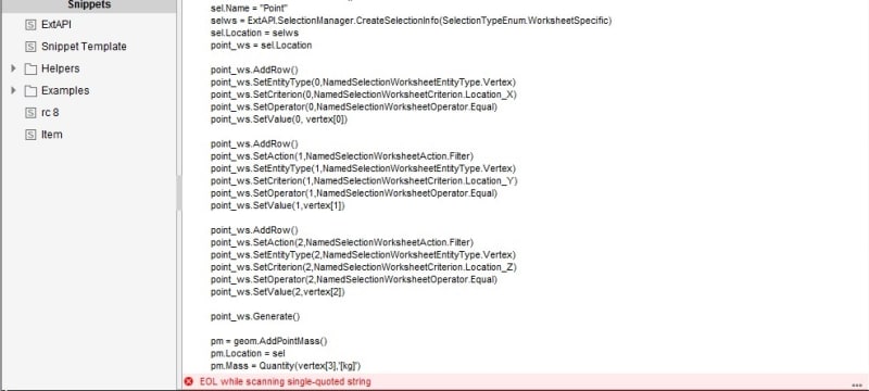

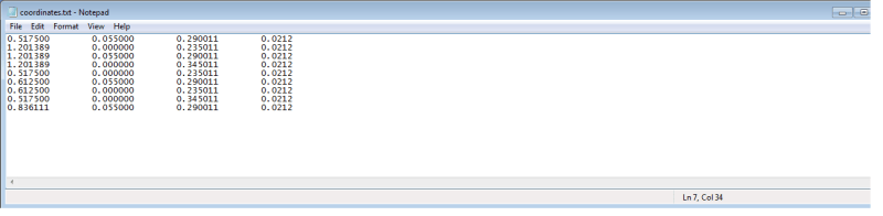

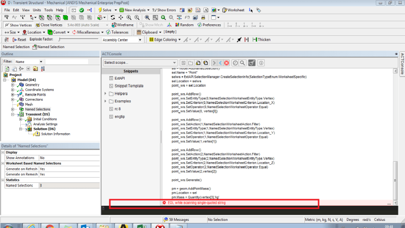

I have created "coordinate.txt"file in folder named "user_files" and run code which is given by you in ACT console.
But i got error message "EOL while scanning single-quoted string".Please check following screen shots for your reference.
Kindly help on above error
Thanking you
Regards,
SACHIN46
The picture is a bit fuzzy. Is the last row missing parenthesis in the end?
even if I put parenthesis for last sentence it is showing same error.Please check following image
I just tested the code in 17.2 and it worked in Windows 7. Are you by any chance on Windows 10?
Try running the code one line at a time. I suspect defining userdir variable is the cause of problem
(because of the escape character \).
Based on link, try perhaps...
Python:
pm.Mass = Quantity(str(vertex[3])+" [kg]")
Kind regards,
Jason
Last line of the code I posted is following.
Kg is not in parenthesis.
pm.Mass = Quantity(vertex[3],'kg')

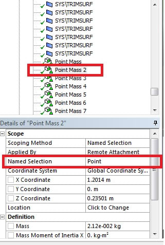

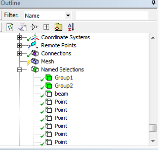

Hi L_K ,
I got my error [smile2] code is running well .Thank you very much for your help.
Only thing I am looking in code that in "named selection " location of point mass is coming under the name "Point".
It will be better if it comes as "Point 1,point 2, point 3,.......",so that for assignment of Named selection for particular point mass it will be easy. e.g. Point Mass 2 named selection such as "Point 2 "will be useful instead of "point" only.Please check following image
Thank you
There are a few options. One is to use enumerate to keep track of
the index:
for num, vertex in enumerate(coordinates, start=1):
sel.Name = "Point " + str(num)
pm.Name = "Point " + str(num)
