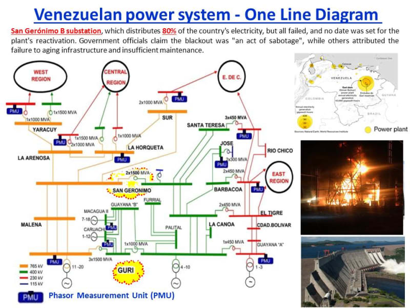

The system is characterized as follow:
1) 80% of the country's electricity come from the hydro generation.
2) Bulk power transmission voltage are: 765 kV, 400kV, 230kV and 115 kV.
3) There are modern Phasor Measurement Unit (PMU) that many utilities in developed countries do not have.
The question remains: sabotage or lock of maintenance program?. I was unable to find a credible independent source to confirm the cause of consecutive blackout in the middle of a political crisis.
Below is a basic Illustration of the electric system of Venezuela.
There are 2 main public explanations or theories:
1. Virus infecting the control system or hacking, EMP attack on transmission lines (!!??), and physical attack on main transformers similar to sabotage on Sillicon Valley substation (2. A series of unfortunate events and lack of maintenance.
I suppose this should be matter of study for Universities, electrical engineers and experts around the globe, to avoid this happen in their own electrical grid.
