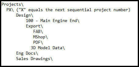

Our vault is set up with 3 major folders Internal Projects, Projects, and Library. Both Projects and Internal Projects have the same folder structure, just that all the files within the Internal Projects start with "IP" and Projects start with "P"
The folder structure for both of those folders is as follows:
Under the design, the Folder is where all the files are stored but within 11 different folders. That is only because of the nature of our business. In the past, I would normally just save all parts, assemblies, and drawings to the Design folder.
The library folder is set up to house all the referenced or purchased files that we use regularly. I have them set up by the type of component. For example, if I have a clamp I make a folder named "Clamps", and any and all clamps I would place in that folder using the purchased part number.
File naming for our designed parts like I mentioned starts with either IP or P. The 2nd set of numbers follows the folder that the file is saved in. Which starts at 100,200,300, etc. Finally, the 3rd character for parts is the next sequential number starting at 1. Assemblies will have an "A" in front and the next sequential number starting at 1. My drawings match the part\assembly number, but I have to add to it. The 4th character is one of two options F = Fabricated, and M = Machined with the next sequential number starting at 1. Sometimes we can have up to two to 3 different drawings for one file. The reason is that Fab drawings using fractions and Machine drawings use decimals. Unfortunately, SW does not support multiple units within multiple drawing sheets without overriding every dimension in the drawing and I never use the override dimension or units. It's easier to just make another drawing so there is no confusion on the floor.
This numbering scheme is simple and does not back us into a corner nor do we run out of numbers.
