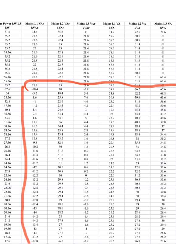

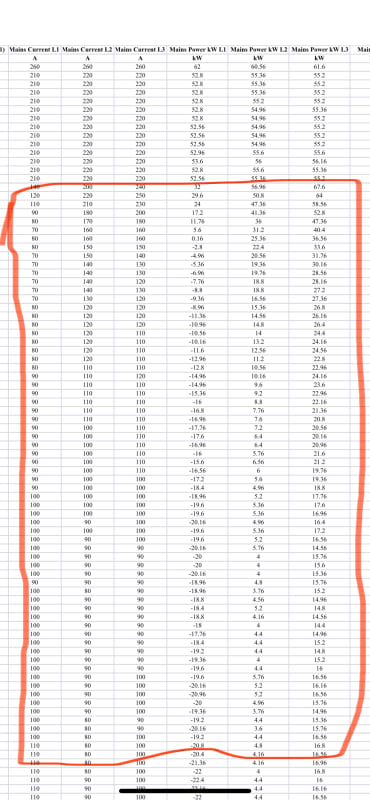

Hey all,
Trying to export to the grid through a step up transfer but gens are tripping on a kVar imbalance. I believe there isIs anyone aware of any equipment i can install at the generator to minimize or eliminate phase imbalance?
Is the generator looking at the delta?
Is the wye on the high voltage side and is the wye point solidly grounded?
Can you high resistance ground the wye point?

@jghrist its a phase imbalance that occurs when synching to the grid for export.
@waross the generator is looking at the wye side. From the drawing it does not show solid ground and also the Xfrm is at 5% impedance in lieu of the recommeded 6% per IEC 60076-5. Also, yes we are a long distance from the substation as well. Upon reading more of the report today i did confirm that the line to neutral voltages are equal and the Line to Line readings are the ones that are imbalanced.

Just want to start off by thanking everyone for chiming in on this. I was able to gather some additional data today and found that voltages are stable line to line and line to neutral on all (3) phases when the issue occurs. However current, kW, and kVar are irratic. Ive attached some screen shots as well. I didnt bother with screen shotting the voltage as it was stable over the entire event.

It almost looks like to me that you are losing a phase while running and connected.
Line to Line voltages are not blinking at all. They stay steady at 480 +\- 2 to 3 volts.
@wcasey it really does look that way but voltage is steady.

@waross i was FINALLY able to do a trend on the primary while the generator is not running and the voltage is erractic. Just over the last month its fluctuated 16V with lowest at 474 and highesr at 490. They are doing alot of switching on this line
“If my critics seen me walk on water they would say its because i cant swim”
- M.T.-
I suspect that when the generator is online, that it will be correcting the voltages with reactive currents.
The reactive currents will cause a voltage drop in the line back to where the unbalance originates.

Thanks guys, @Casey i only pulled a small sample size for about a month and all three phases have the same characteristics. When trended the primary voltage with no gen connected resembles a richter scale or a polygraph of me saying i like my wifes meatloaf. In this particular case the utility has admitted that there is an issue and we are planning to study the system to find and fix the culprit.
@waross we suspect the issue is further down stream as you mention. We will continue to investigate but your scenario above looks very similar to what we are dealing with.
