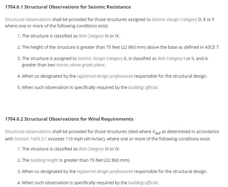

Special inspection does not take the place of structural observations. If you are required to provide an observation per CBC 1704.6, with many cities requiring under item 4, then either the EOR or a registered designed professional hired by the owner will have to do the observation.
I'm aware and that's really part of what makes me appreciate the setup in California:
1) Plan review and structural inspection are rigorously reinforced.
2) There remain many opportunities for which stuctural observation is not required.
3) When structural observation is sensible, it's required.
I doubt that anybody wants to be designing dams or hospitals on the San Andreas without a local presence. Fun rich people houses and light commercial... sure.
1) Is very debatable
2/3) Many local authorities will require observation even if the building does not need it per code, item #5. Fun rich people houses will need observation in most of LA, same for commercial, and 5 over 1 podium even thou they do not need it per code.
What is structural observation? And what is the consequence if one does not comply?

You are reviewing the structure for general conformance with the approved drawings. Are the shearwalls correctly located, they sill plate washers, nailing pattern is correct, grade beam reinforcing correct, deck attachment, steel beam, conc./CMU embeds are correct, etc. The AHJ can hold up occupancy until observations are provided at each stage of construction.

I was only pointing out that many locations require observation as part of plan approval and how to accomplish the goal if you are out of state.
Unless each observation is accompanied by a city official, or requires the presence of third party personal, the requirement seems adding to another paper work only.
Structural observation adds tangible value and certainly warrants the additional paperwork for significant works. This structuremag article does a good job of elucidating the differences between the different levels of quality assurance: Link
...and Structural Observation performed by the Engineer of Record (EOR) or his/her designee.
