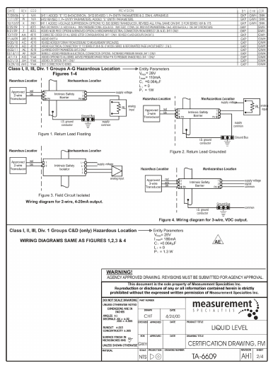

It is my understand unless everything is "simple apparatus", the control diagram must be from the equipment manufacturer.

This image is one page from the certification document for a kpsi intrinsically safe pressure transmitter. This document is what the mfgr supplies. A designer will use this information to create a NFPA 70 504.10(A) compliant control diagram.

We always do Termination Drawings and Loop Drawings for construction and commissioning which is very similar to the control drawing mentioned above, but very specific for each loop.
