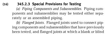

345.2.3 supports my thought process

DekDee, please see the quote from asme B31.3 below,
345.1 Required Leak Test
Prior to initial operation, and after completion of the
applicable examinations required by para. 341, each piping
system shall be tested to ensure tightness. The test
shall be a hydrostatic leak test in accordance with
para. 345.4 except as provided herein......
Also refer the below quote too....
(b) Flanged Joints. Flanged joints used to connect piping
components and subassemblies that have previously
been tested, and flanged joints at which a blank or blind
is used to isolate equipment or other piping during a test,
need not be leak tested in accordance with para. 345.1.
We must understand the entire piping system to be pressure tested as per ASME B31.3 which includes flange connection too..
Ishack,
Read what you have posted
If you hydrostatically test flanged sub-assemblies prior to assembly there is no code requirement to test the whole system once assembled.
DekDee, Thanks for posting. You are absolutely right as flange connection need not be tested if it has been previously tested. But how about the flange?. My point is that component "flange" to be pressure tested if it is welded to the piping line, not just the weld that connects the flange to pipe/fittings (please refer the original question posted).
