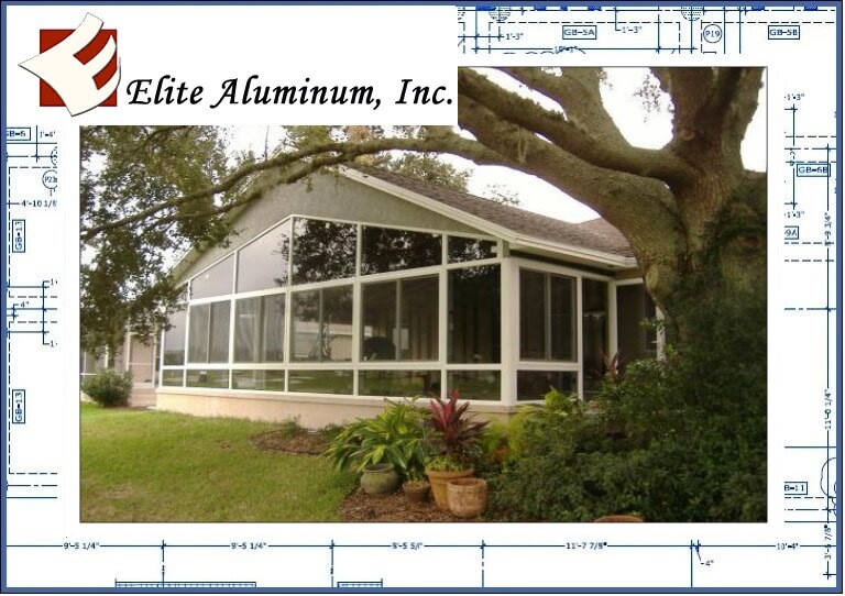

Or you could order a set of engineering from a company like below.
I
Here is a site with engineered rooms.
Preengineered plans:
