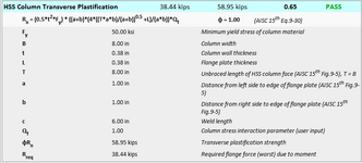

I have an unusual canopy connection with W12x30 beams framing into an HSS 8x8x0.375 column. They connect at different levels. There is a continuation of the beam on the opposite side of the column. I'm planning to field weld 5/8" end plates on the beam ends to the face of the columns as shown. Does anyone have any concerns about this approach? Worked a better approach. Thanks...

What size of flange plates are you using for this? I ran a quick check in RISA Connection, and I'm noticing some differences in your approach. Notably, they are taking ro as being 1.5tr, not 3.0tr for the local yielding of HSS side walls. They also appear to be using different equations, unless they/you have simplified it in any way; the one most different is the HSS Column Transverse Plastification, or your Rn1.
BAR 5/8x6 for the large moment and 1/4" fillet welds and BAR 3/8 x6 and 3/16 fillet welds for the small moment. Does RISA list the formulae it uses? It still works at 1.5 for ro
They are showing AISC 15th edition, Eq 9-30 for that specific calculation. What reference did you use? The value is MUCH smaller in RISA (not so small to become the governing limit state however).
The capacity based on 9.30 is OK...
Does RISA list the formula used that gives the low value? I'd be curious to see what it is.
This is one of the equations among many others they check. But this is one that is different from what you used; it doesn't use beta's or n's.

Thanks... it's 9-30, I've already included it.
