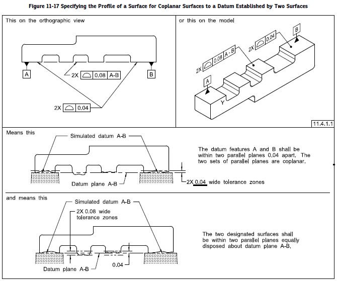

I am not trying to hijack this thread, but I think its almost the same issue regarding the tolerance applied on the datum features. We are talking about only half of the profile tolerance is applied on the datum feature at Fig. 11-21 for the newly added definition on 2018 version, but please see the figure 11-17 as shown below, why not half of profile tolerance(0.02) is applied here? Thanks for anyone who can help me to understand the differences between them.

The 2X 0.04 datumless profile tolerance applies to ONLY the outer 2X surfaces. These surfaces are referenced as datum features A and B in a separate FCF.
The 2X 0.08 profile tolerance wrt |A-B| applies to ONLY the inner 2X surfaces.
The entire profile tolerance zone is available for both, unlike 11-21. For it to be like 11-21 where the tolerance zone is halved, one would have to eliminate one of the profile tolerances shown and instead have 4X profile wrt |A-B| (and the proper associated leader lines). Even then, it would only be halved for the outer 2X surfaces, the full tolerance zone would still be available for the inner 2X surfaces.
Edit: I will conceed there seems to be a poor combination of leader and extension lines, but the 2X on each seems to communicate the intent shown in the "means this" portion.
SeasonLee,
The entire 0.04 wide tolerance zone can be used in this case, because there is no requirement for the zone to by symmetrically disposed about datum feature simulators A and B, because the profile requirement is datumless.
