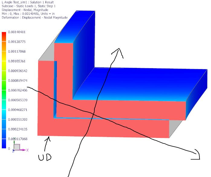

Dear All,
Sorry for this basic question. I learn in past Mc/I only applicable to principal axes.
But this professor use neutral axis, which is at angle to principal axes to find max and min point, but use principal axes for stress?
Here is link:
So my question: If use neutral axis, I get same point for one end 'B'.
But if use principal, I get different point for 'A'? Which is correct? See image below.
When you do section bending + axial (assume shear zero) check of any unsymmetric section, you use principal or neutral for extreme fiber and bending stress?
I know neutral means no axial stress, and principal means no Ixy, meaning no twisting if applied moment is not aligned with principal.
I also not getting same stress distribution (where is tension where is compression) if use principal compared to neutral using Mc/I.
May be I am doing wrong. See image below, bit confusing. What you think?
rb, the load is not a force, its a moment at the end. I could hand calc, but wanted to see FEM too.
"If Iyz=0" = if the section is symmetric. Here Ixy is finite, so we have principal axes (inclined to the geometry x- and y- axes).
KS ... ok, a cantilever with a moment.
But you've already hand calc'd the stresses from the principal axes, right? So from those stress you can deduce the NA, then transform the applied moment into this axis, and the "y" from this axis (seems really confusing and circular).
Your sketch is further confusing 'cause it shows stresses at different location (the principal axis method says peak stress on the standing leg, the NA analysis says the horizontal leg. Maybe this is for "clarification" ? But if both methods are right then they should give the same results. The principal axis method is certainly correct (if calc'd properly !) IDU this "NA "method, other than as a check ... there's no way to determine when there is zero stress without doing the principal axis analysis (which solves the problem so why do more ?). You know INA from your principal axis derivation (at some angle to Imax). If I were teaching this, I'd compare the principal axis stresses with those from using Ixx.
How does the angle FEM deflect ?
Yeah, is why I put in red, I not sure if it was correct, extreme points was confusing.
But now I think I know, point A on upper leg using principal axis system will not be highest stress compressive, only point A on horizontal leg using NA will be, is it better?
Both method will not be correct for the same points.
Neutral gives you the correct points, principal gives stress at those points.
If you use principal for points, you will get wrong A.
In this case top leg corner, and wrong max compressive stress, which is at other point A on horizontal leg.
Yeah?

It would be interesting to see how the non symmetrical bending equation compares to FE.
fz = [(Iyy.Mx + Ixy.My).y - (Ixy.Mx + Ixx.My).x] / (Ixx.Iyy - Ixy^2)
Choose an appropriate coordinate system. How close are the results?
that would (should) be the same same the principal axis method ... you're using the components of the principal moment of inertia instead of the principal MoI themselves. But it would be a check on the principal axes results.

See below deformed plot with undeformed marked in black at midspan, why is no aligning with principal axes? In fact its turning counter clockwise?

rb, my pic was just what I thought it should be as I use principal method, compared to what professor had, so it was no correct.
We know now NA method only gives two extreme point for max and min principal stress, like you said other points with one edge free leg may be more critical for cripple.
I have no NA method, NA only show correct points just for min and max stress, yea?
But I still not sure why section turning counter clockwise, away from principal? End fixity in the FEM causing it maybe?

thinking about the rotation ... if I was this angle, I'd twist to align the strong axis with the load ... in this case so the bending moment is normal to the strong axis. I think that should minimize the strain energy.
Umm, but in this case, strong axis (y') rotates to be in line with moment axis, not perpendicular?
