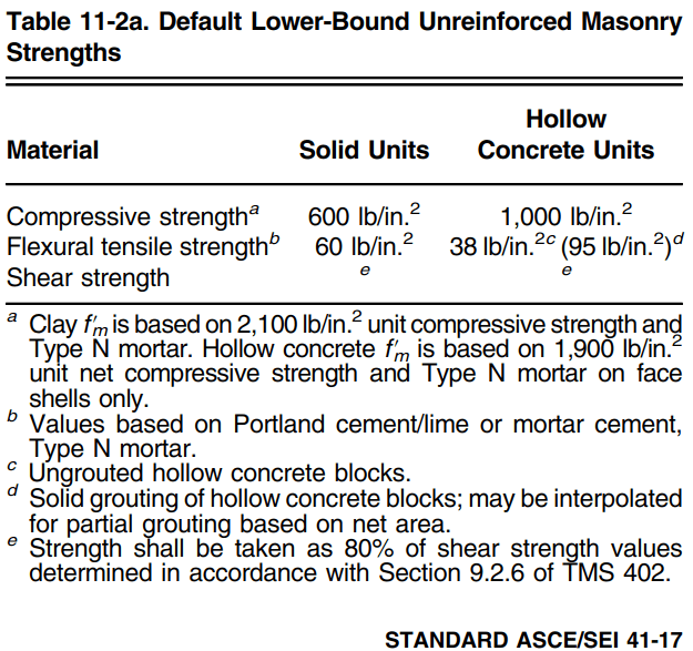

For the strength values, check out ASCE 41-17 table 11-2a and that particular chapter of code.
The flexural tensile strength they have is actually a bit higher than I'd expect, but it's in an authoritative publication, so I see no reason not to use it.
milkshakelake, based on this table, what do you use as the allowable values for ASD method?
