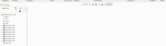

I am helping someone out. We are on Creo 3. See attached. What are the parts with grey box and dashed line outlines? Seems like an assembly feature driven item like flexible assembly???

The thumbnail is too small to see the icons easily, but it looks similar to the icon for hidden components. If I am correct, then to see the component just right-click & select Unhide. If you need to permanently unhide the component, you will need to save the layer status.
I agree, it's pretty hard to read, but they also could be "included"components.
These are components that you want to show up in the BOM but not on screen. You'll find the "include" command under the "assemble" drop down menu.
If you want to place them, you can right click on them and select edit definition and you'll be taken to the placement dashboard where you can define constraints. I don't think you can go back, however, without deleting it and re-including it.

U got it Doug! Thanks!

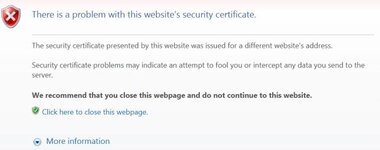

BTW...is there anything going on with PTC community? I am having trouble getting into site due to a certificate issue. May be on my side. But not seeing the usual emails I generally get either.
I got a security warning there too just a second ago.
Ok.....good its not just me.
They switched backend software on the PTC Community so all the URLs changed and you'll need to resubscribe to the areas you're interested in. The old URLs should redirect, however. I just tried ptcusercommunity.com and it redirected to community.ptc.com just fine.

Thanks Doug. I still get the attached when I try to go to main page......
