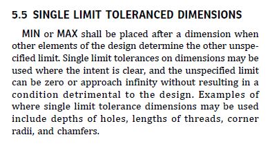

I'm calling out the depth for a hole, is there any reason why I would use unilateral over max, min callout ?
Thank you.
MAX and MIN are "single limit" tolerances and not intended to be used together.
You can specify your tolerances as unilateral, bilateral, symmetrical, or as limits - 21/20.
Just to add to what CH noted, what standard do you go by? ASME Y14.5-2018 has the below to say about single limit MIN/MAX tolerances. The 2009 version is similar in this respect - MIN and MAX have special meaning and are not interchangeable with any variation of +/- tolerances including unilateral, bilateral, and limit. Limit dimensioning is probably what you were thinking of and would just be denoted 21/20 without any MAX/MIN notation.
